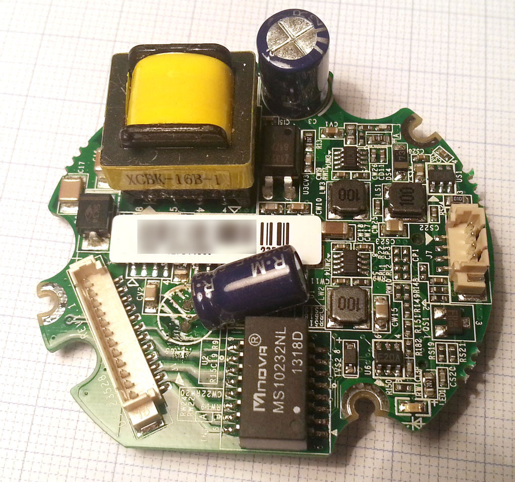

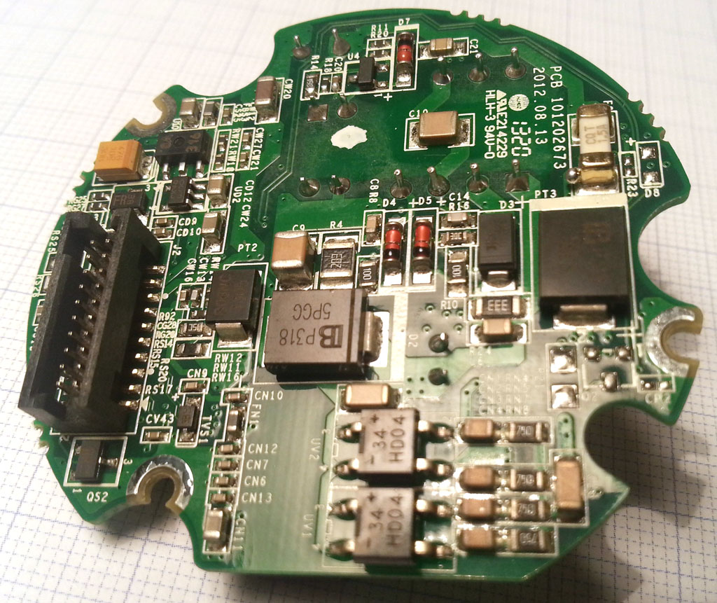

Here's a closeup of the same board, but fully removed from the housing:
The other side of the same board:
Note the black board-to-board connector. This is where it connects to the mainboard with the CPU, which you can see here, while it is still sitting in the housing. The ethernet PHY and the flash is also here, but unfortunately I forgot to lift off the label on the flash, so I don't have the part number:

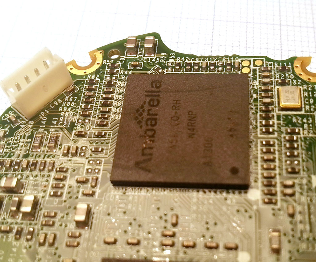

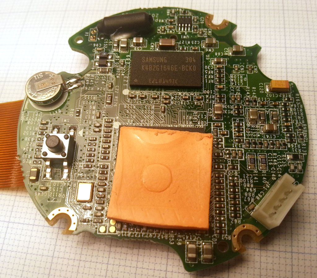

Here's the other side of the main CPU board, removed from the housing. Note the reset button and the 256MB DDR3 SDRAM:
If we lift off that orange sticky foam from the CPU, we can see (not easy to see from the image, I admit) that it is a Ambarella A5s SoC. The connector at the upper left is not connected to anything, and I'd be willing to bet that it has the RS232 pins to get access to the bootloader. I didn't test it, though:

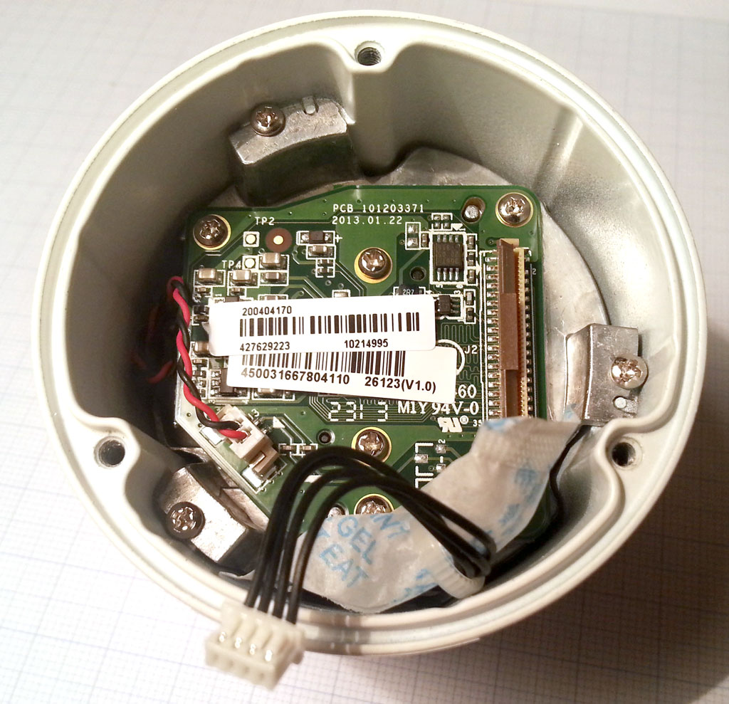

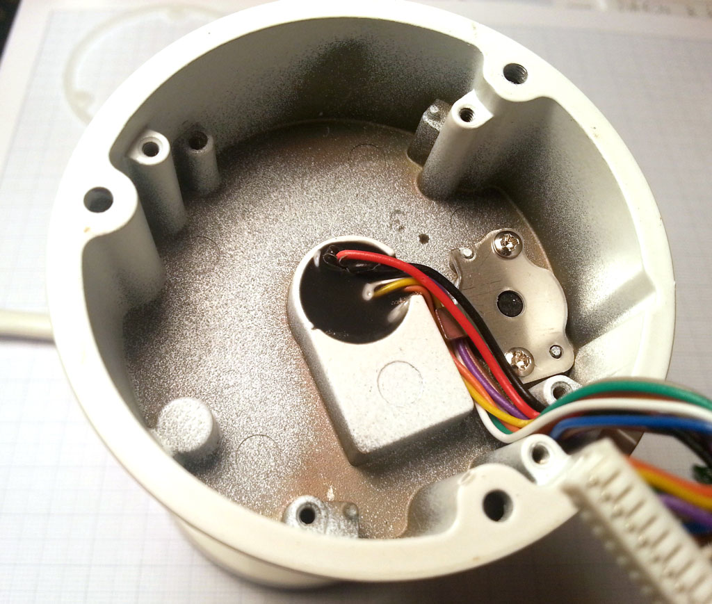

Here's the rear housing with all the electronics removed. As you can see, the cables are embedded in some kind of rubbery sealant where they enter the housing, so they can't be easily removed. Keeps everything pretty waterproof, though:

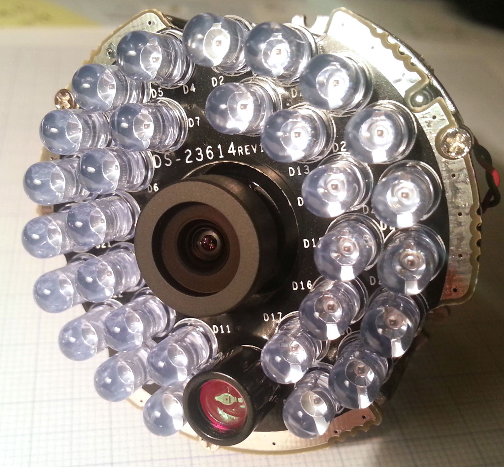

The front part of the housing has the lens and IR-boards, and looks like this while still attached to the housing:

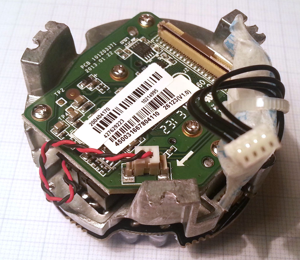

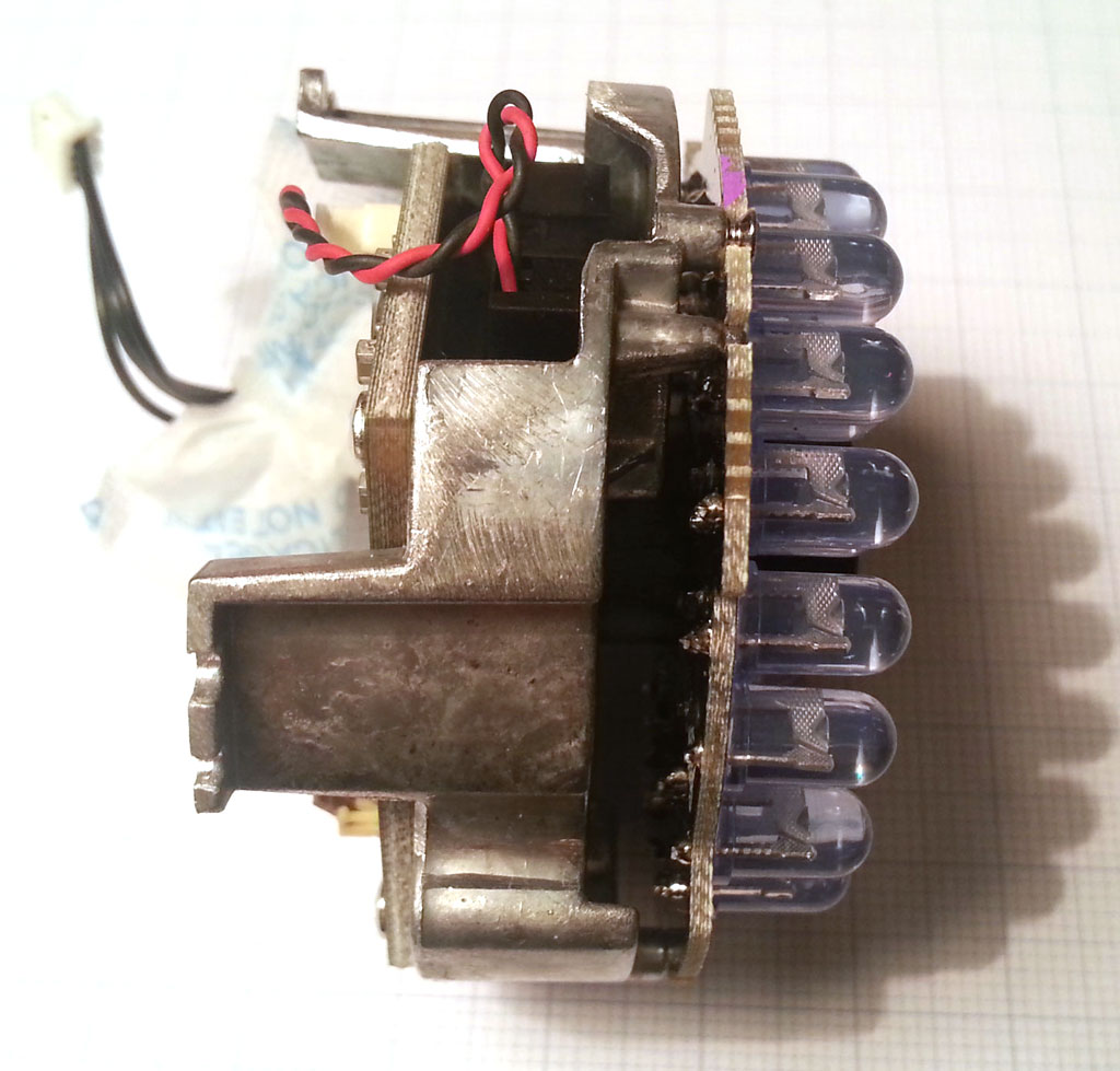

The assembly removed from the housing. Note the small silica gel bag that has been zip-tied to the cable to keep moisture low:
Here's how it looks from the side:
And finally, here's the front of this assembly. The lens is glued, as others have said, but it is not easily visible in the image. If you look closely, you can see a shiny little speck at around 1 o'clock, but there is quite a bit more glue there:

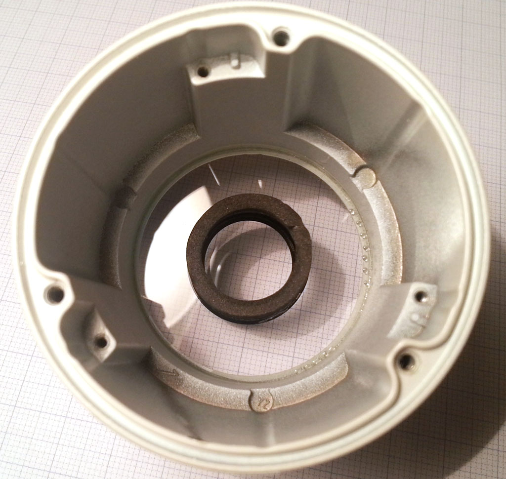

And finally, the empty front part of the housing:

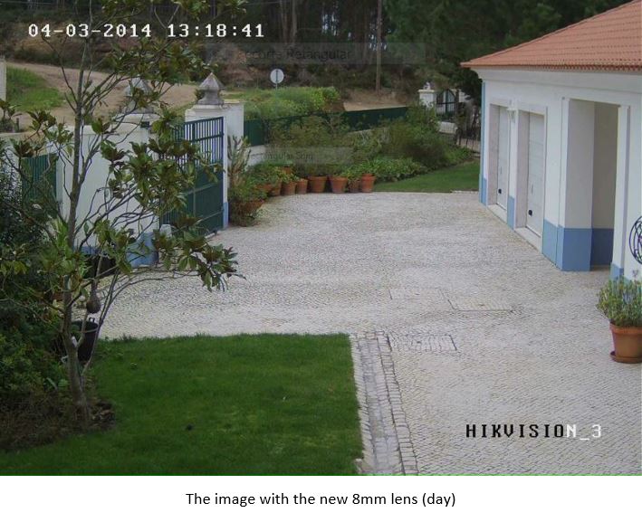

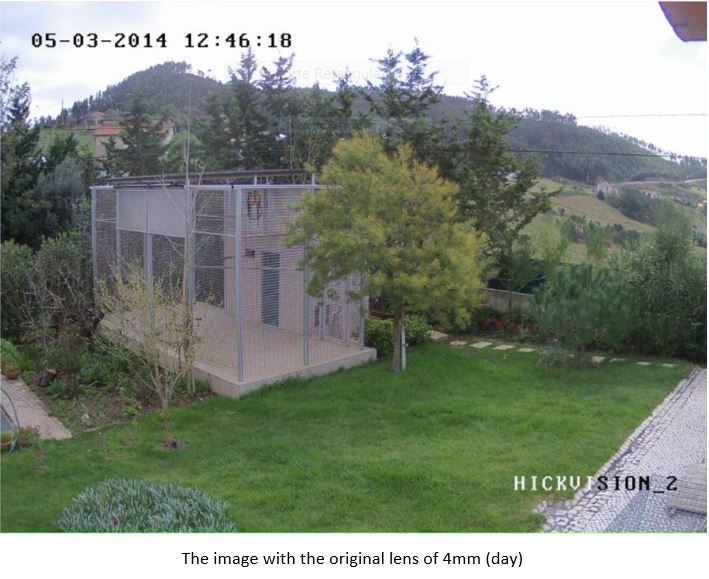

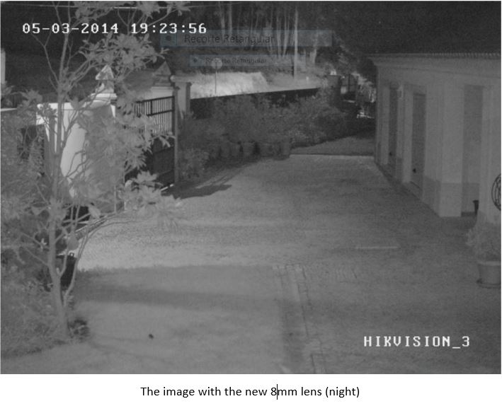

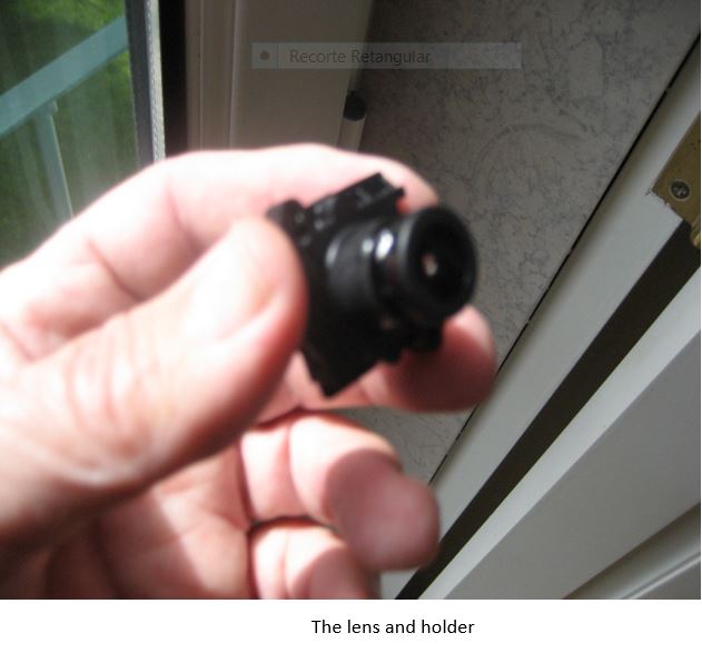

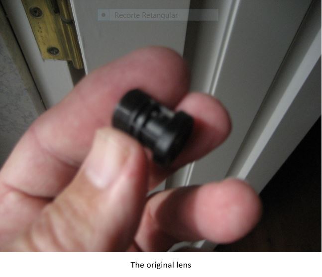

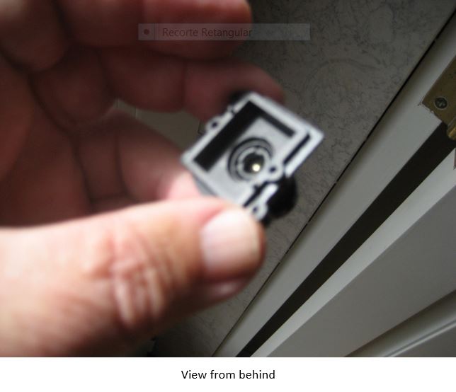

At the first camera (HIKVISION_3) I replaced the original lens of 4mm by a new one of 8mm.

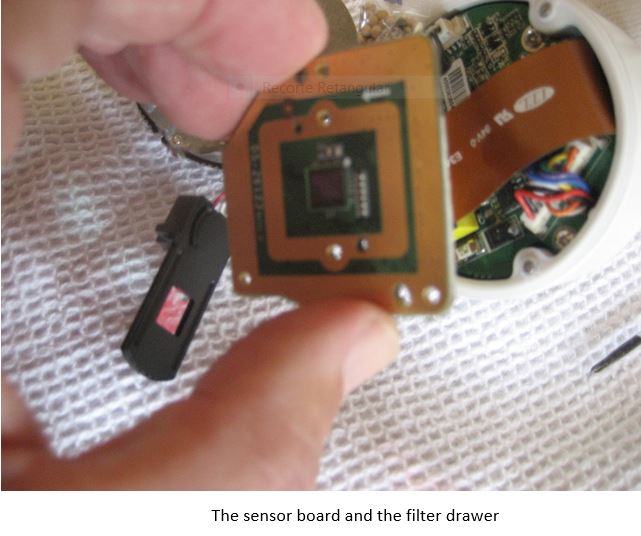

To do this I disassembled the camera and removed the lens holder which greatly aids the work of removing the two pieces of glue that are holding the lens.
Before removing the lens holder do not forget to remove the filter drawer.
To soften the glue pieces I used a cotton swab dipped in PVC cleaner, then removed them with a tweezers with fine tips.
Never use solvents, as the support of the lens is plastic.
Testing the product on a small area of the lens holder is a good option to verify that it does not spoil the plastic.
In order to ensure that will not spoil the filter when you are searching for the focus, I advise that you screw the new lens to the level of the rear face of the lens holder before assembling again the block.
So when looking later for the focus you just need to unscrew the lens.
Just for reference I inform you that the focal point was obtained when the top of the lens is at the same level of the top of the IR LEDs.

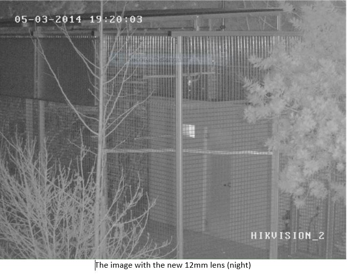

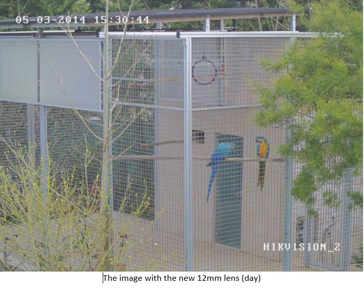

In the second camera (HIKVISION_2) I changed the original 4mm lens for a new one of 12mm by using the same method.

the Ambarella SOC is A5S on this model ?you sure ?
what sensor??
We also have Ambarella SOC products, the day image is similar, but ours have contained more details;
Do you produce surveillance cameras? What do you mean by " ... more details.."? What sensors do you use do get better image quality?
Please provide us with more info.
what sensor??
I don't know which sensor it is, but I'm sure the chip was marked A5S.

Could you maybe find out what is behind the sticker with the serial number that is blurred out? I think I can see 2 IC's there.
The reason for asking is that I want to modify the PoE circuit so it gets recognized as a class 2 (802.3af) device. For this it needs to pull around 18 mA during the signature phase. (https://en.wikipedia.org/wiki/Power_over_Ethernet#Configuration_via_Ethernet_layer_2_LLDP) My Netgear GS105PE switch otherwise refuses to send power to the camera because I suspect it to have no signature at all, making it appear to the switch as a class 0 device, to which the GS105PE only supplies power when its fed by a 802.3at PD, which I do not have.
I was hoping that there would be something like a TI TPS2370 (http://www.ti.com/lit/ds/slus537c/slus537c.pdf) in there that just lacks the signature resistor.
