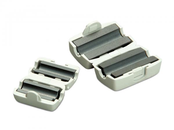

The switch wouldn't have occurred to me but it's worth a try. Also You could try ferrite rings on your HDMI cable. You can buy split ferrites and tape them onto the lead at each end. It will certainly have an effect but how much is a 'suck it and see' question.
ok I had the sparky come back over I got him to put a new fan switch on the wall and try that did nothing . I bought one of the ferrite rings and did nothing .
