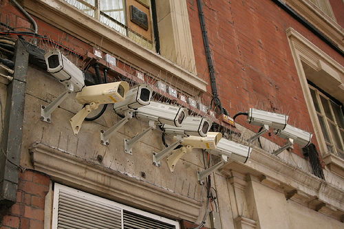

Interesting picture... Dont do this. lol
