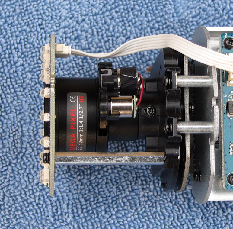

MaxIcon 0 Posted August 9, 2013 Thanks, most likely is auto iris and ir filter Here's the Dahua HFW3300C varifocal lens, as a comparison. One connection is for the IR filter, which is part of the lens on this camera, and the other is the iris. Most lenses have the IR filter separate, but vendors seem to be moving towards integrated IR filters on varifocal lenses to save money, likely on the theory that the lenses are much less likely to be swapped. Finding a replacement for this would be tricky, as you'd have to match both the IR and auto-iris drive signals and connectors. Share this post Link to post Share on other sites
