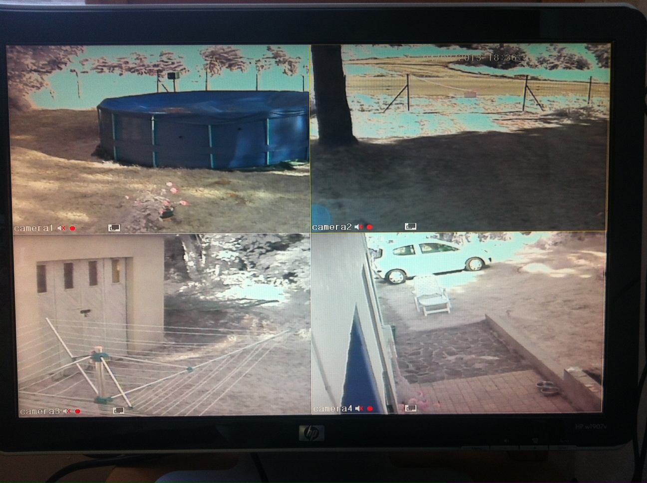

At day - colors don't show up "right" (grass is not green, pool not so blue etc).

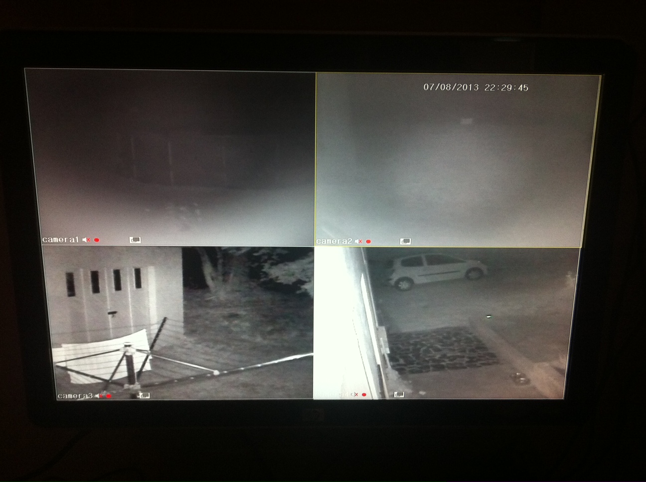

At night - pitch black. you can't see anything IF something will occur...
Day: http://oi44.tinypic.com/x5qr7c.jpg
Night: http://oi43.tinypic.com/2ilmrkl.jpg
I did setup all the things I could,
Tried switching from PAL to NTSC (although I'm in France - SECAM),
Tried playing with hue, brightness - what haven't I tried. nothing.
It's not the screen, that I can assure you. on startup - all colors looks great,
Then the DVR kicks in - the split 4 shows up - and the situation is as shown...
Any ideas what's wrong over here??
My primary thought was "the IR light don't go so far - that's why it's black",
BUT - thing is - the garage door (bottom left) is even further that pool (upper left).
So apparently it's not that reason :\

cheap DVR cheap cameras and bad lead kits. DVR even holds you back as its only a CIF unit

So that's it then, eh? the colors will be like that for good... ah sigh!
It's strange thought,
Blue looks like blue (kind of faded) and Pink looks the same (faded),
Rest is all like B&W... no greens, no yellows, nothing quite shows up.
As for the "pitch-black" shots in the night, is it also doomed??
