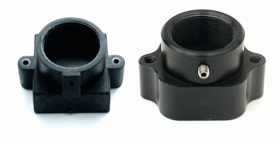

M12 lens mounts typically have an allen head setscrew that lock the lens in position after it has been focused.
Some lenses have a lock ring instead of the allen screw, and the Hik mini-bullets have a spot of glue on the threads holding them in place that needs to be scraped off first.
Most M12 lenses have an image spot large enough to cover slightly larger sensors, but M12 lenses don't have strong specs for this kind of thing, unlike older CS mount lenses. Likewise, if the new lens needs to be screwed in too far to focus, it'll hit the IR filter assembly before it's in focus. This is a common problem on replacement M12 lenses if the back focus length is too short, and few vendors specify either the BFL or the image spot size.
You pretty much have to order one and see if it works. If not, well, try, try again!
