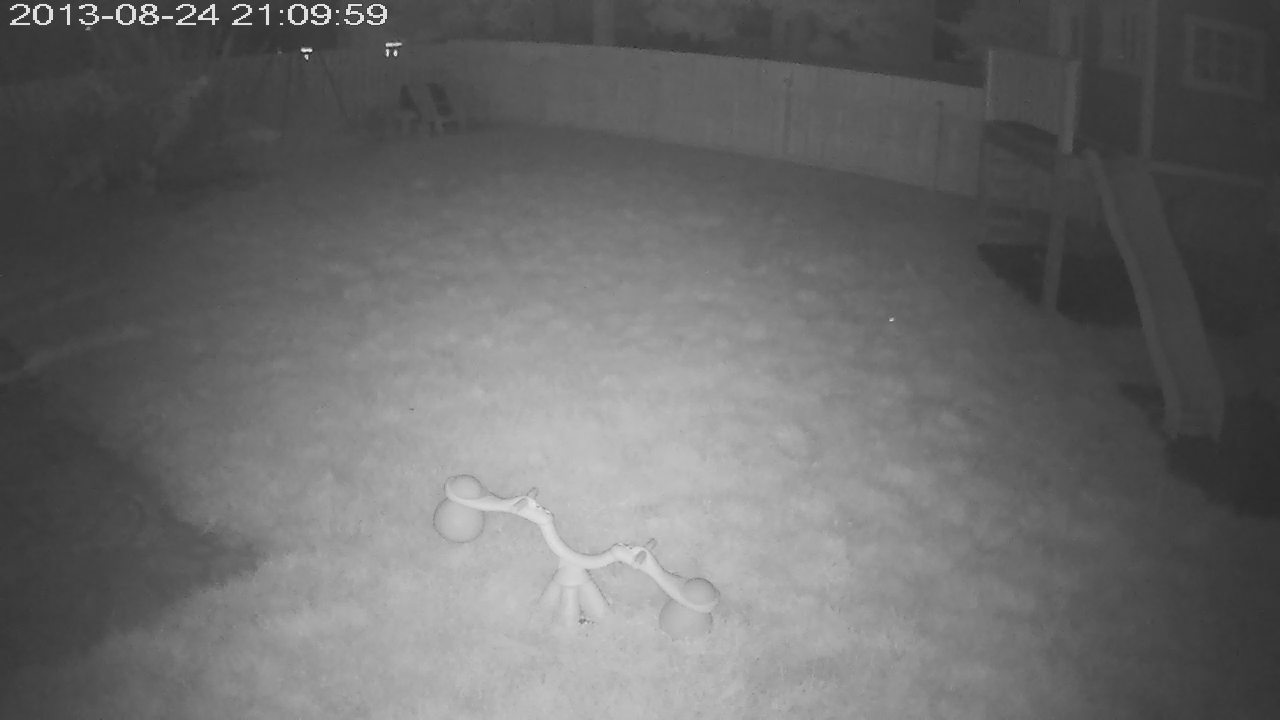

ayryq 0 Posted August 23, 2013 I finally got my first IP camera installed yesterday, mounted on my garage facing my backyard. It's a Dahua IPC-HFW2100. Here's a picture from just now: And here's an image from last night: They advertise 20m night vision. It's 45 feet from my garage to the fence, so maybe 60 feet on the diagonal where I've aimed the camera. But I did expect to be able to see the toy in the foreground. Playing with a tablet out in the yard I was able to see myself illuminated if I stood in front of the camera, and the IR LEDs are glowing red, so they're on. Is this night-time performance "normal" or should I expect better? (I hit the "default" button on the web interface but I won't be able to see if that changes anything until tonight.) Thanks, Eric Share this post Link to post Share on other sites

ayryq 0 Posted August 25, 2013 So, tonight, following the seller's suggestions I unscrewed the camera from where I had it mounted, unplugged it, brought it into the garage and hammered a nail through one of the mounting holes. I hooked it up with a 1ft CAT-6 patch cord to a different port in the POE switch. When the sun set, my garage was fully visible on the camera, and a license plate on the far wall was glowing brightly. I doubted that the problem was the wire, so I moved it back to the back yard and hooked it up. Well, all the movement must have unstuck something, because now the night-vision works great. I can switch back and forth between day and night mode, so (as far as I can tell) the IR filter isn't just stuck "off" now. So here's the $168 question: now that it's working, will it continue to work? I.e., was the stuck IR filter a problem just because it was new, and now it'll be fine indefinitely? Can those of you who succeeded with the bashing, magnetizing, and shaking confirm that your camera is still working? Oh, here's a picture of the backyard now. Looks like I may need to clean the front after all the handling today: Share this post Link to post Share on other sites
