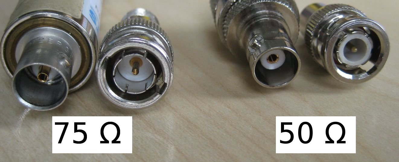

I'm not sure the cameras are 50ohm, just that the BNC does not fit a 75ohm, but fits a 50ohm.

By the way, the camera is 75 ohms and you will need 75 ohm cable. BNC = BNC (as far as the connector side) and you can safely use 50 ohm or 75 ohm BNC's as long as they will properly crimp onto the cable selected. RG59 copper-copper is good to just about 1,000 feet. RG6 copper-copper is good to about 1,500 feet.

You may want to try another connector, I've never seen a CCTV camera with a 50 Ohm output. Even with the differences in connector design between 50 and 75 Ohm connectors, they can still interconnect. Copper clad steel cable will doom your project, both for signal loss and interference. It is only designed for use with modulated high frequency signals, not baseband video like CCTV signals.
