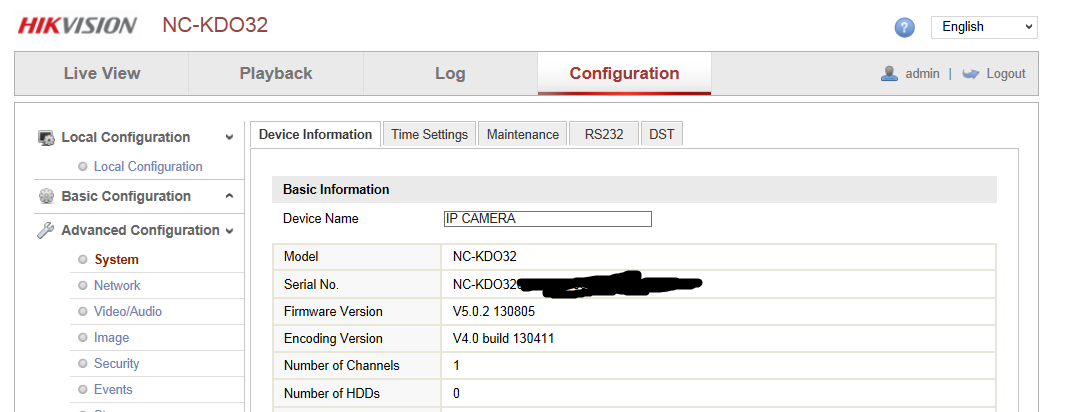

zikronix 0 Posted September 6, 2013 Well that explains a lot in the differences from the official derytech and the official hikvision the derytech firmware I just got was V5.0.0 130618 but the derytech camera shipped with V5.0.0 130719 (I swore it said 5.0.2 13805) any way an attempt to flash the camera with the hikvision firmware via tftp worked and kept the password...duplicating now with screen shots....standby Share this post Link to post Share on other sites
zikronix 0 Posted September 6, 2013 Disclaimer and well a little fun: This has been tested on a few cameras and it worked fine...but if it breaks your crap dont come cry to me about it...you knew the risks! No one here is responsible if you break, brick, set fire, punch, smash, stab, destroy, yourself, computer or your camera. The only person responsible is you! Just because it worked for me and others does not mean it will for you. Anytime you flash something its a risk. There will be flashing: Ladies and gentlemen... I've traveled over half our forum to be here tonight. I couldn't get away sooner because I had a camera coming in and I had to see about it. That camera is now flashed and running well. I have many others coming in and this method will be used to flash many of my devices. So, ladies and gentlemen... if I say my guide might work you will agree. You have a great chance here, but bear in mind, you can lose it all if you're not careful. Out of all methods that beg for a chance to flash your camera, maybe one in twenty will work; the rest will be trolls-that's posters trying to get between you and the guide-to get some of the flashing action that ought by rights come to you. Even if you find one that has a simpler guide, and means to flash, they'll maybe know nothing about helping. This is... the way that this works. This method is may not be reliable like no other in this field and that's because its been its been barely tested and tested time and time again. I assure you, whatever the others promise to do, when it comes to the showdown, they won't be there... My History: Im an IT guy that's been in the field for a long time, more importantly im a tinkerer, from Xbox's, phones, remotes, slr cameras, and many other devices. Ive flashed and hacked a many, Ive also broke a few Missing Admin Password history: Ive had this password problem with the earlier hikvision nvr firmware updates. But it was fixed recently. With that being said I set out to see if I could flash this thing and retain the admin password. Step 1: Upgrade to the latest derytech firmware, in this case I was provided V5.0.0 130618, (note: my cameras shipped with a newer version 5.0.0_130719), so I didn't upgrade hoping that the device was running a fixed firmware. *Note regarding step one. If you have an old firmware going from the derytech to a new derytech could actually cause the same problem with the password. Happened on my NVR Step 2: Download the latest hikvision firmware (as of writing 5.0.2_13805) Step 3: Flash via the web interface. I didn't even have to use the TFTP Notes: If everything takes a dump you might be able to recover by tftping the orginal derytech firmware back to the device. You can grab the tftp files from hikvision Europe. Share this post Link to post Share on other sites
FastEddy 0 Posted September 6, 2013 I notice that you flashed a DeryTech dome and I have the DeryTech bullet (NC-KBU32, f/w V5.0.0 130618) that was sold to me as a HikVision by Wrightwood. I don't suppose that makes a difference? And if the web flashing works without any special effort, why did buellwinkle raise the alarm in the first place? You also mention the DeryTech firmware, but I have not been able to find it. Where might that be found? Thanks to all for the heads up on this! EDIT: Curious, too, that you have the HikVision logo on your config page prior to flashing...very surprising that an unbranded OEM camera would have that logo, isn't it? Mine sure doesn't. Are you certain that this camera wasn't flashed with a HikVision f/w prior to this test? Share this post Link to post Share on other sites
zikronix 0 Posted September 6, 2013 (edited) I pulled it out of the box I will gladly look at the other 12 I have you will have to give me a few though Just pulled one out of the box...see the attached. I think its possible that when I flashed and flashed back and reflashed to take the pictures that it puts the picture there.....lets find out Edit: that's exactly what happened. and as far as why buellwinkle posted about it. because I suspect that, he had an older firmware that had the bug in it that I spoke about above. The same type of bug affected me and joeyjoey. and hikvision has since fixed it. which is why I said actually flashing to a newer derytech firmware from an older version could actually cause the same problem that he talked about. Ill flash this one clean from the box! Note: firmware version 5.0.0_130719 Flashed with hikvision 5.0.2_13805 Im going to downgrade to the dery firmware posted see if it goes away if it doesn't then ill tftp and see if it goes away. EDIT: It did see attached Flashed with the firmware buellwinkle provided me 5.0.0_130618 Flashed back to 5.0.2_130805 Edited September 6, 2013 by Guest Share this post Link to post Share on other sites

FastEddy 0 Posted September 6, 2013 Awesome work, guys! Many thanks for your efforts. I feel like I might have dodged a bullet here [slight play on words]... I've noticed that the reviews on these HikVision cameras seem to generate a great deal of interest for some reason, seemingly more so than the reviews of other cameras. It's good to have such outstanding community support to smooth out the inevitable bumps in the road, especially for us noobs. EDIT: So I guess the take-away from this is that the DeryTech f/w prior to V5.0.0 130618 may have the admin password reset to some unknown value when flashed with either DeryTech or HikVision f/w, but that f/w V5.0.0 130618 or later is assumed to not have this problem? And that a potential remedy for the unknown password problem might be to tftp either the latest HikVision or DeryTech f/w ? Share this post Link to post Share on other sites
zikronix 0 Posted September 6, 2013 Correct you could try tftp method if you have the older and it may work. If it doesn't you'll have to do the one time pass reset via hikvisiom. I don't generally have a problem flashing stuff because I have rom readers, adapters, tracing utilities, boot loader hacking utilities all sorts of off the wall **** most of it acquired during programming ps1 and flashing gold key cards. So sometimes I might fail and brick something and it may be tossed other times its a success Share this post Link to post Share on other sites
