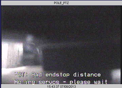

adamxp12 0 Posted September 7, 2013 Can someone explain what this means my dennard 2050 dome keeps doing it and i have to power cycle the dome to fix it also this tilt is very finicky as if a sensor has gone bad or something Please can someone help. this dome is brilliant otherwise Share this post Link to post Share on other sites

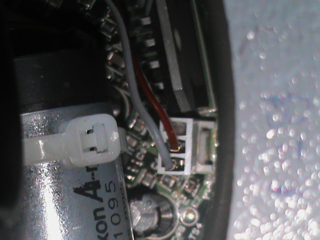

adamxp12 0 Posted September 8, 2013 I fixed the tilt issue which was causing this error by reseting this connection The is another connector near the pan motor but I only had tilt problems Hope this helps someone because i could find no information on how to fix this Share this post Link to post Share on other sites
