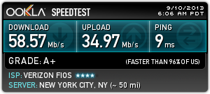

Zohan 1 Posted September 9, 2013 I have one of these http://www.dahuasecurity.com/products/ipc-hdw4100s-399.html The major concern is that I am getting periods where the image will freeze then the screen will go black and I will get the message "resource is limited, open video failed" Tech support was not much help with that one, they say must be something with my network....?? I did a speedtest am am getting 58 mbps down and 34 mbps up..... The camera is connected to a switch which is then connected to the router. The switch is a cheap ass switch i've been meaning to replace but because everything has been good with it I keep forgetting. So, I'd like to start speccing these cameras but not if they will have issues dropping out..... Can anyone point me in the right direction to solve this.....replace switch? router? both? I dont really have time to replace everything in the chain, doing the trial and error thing. Hoping to find the answer before it comes to that... By the way, the dropouts average 1 - 3 seconds....the longest one was for about 30 seconds but that hasnt happened again, it's mostly a second or 2, then right back on. Share this post Link to post Share on other sites
