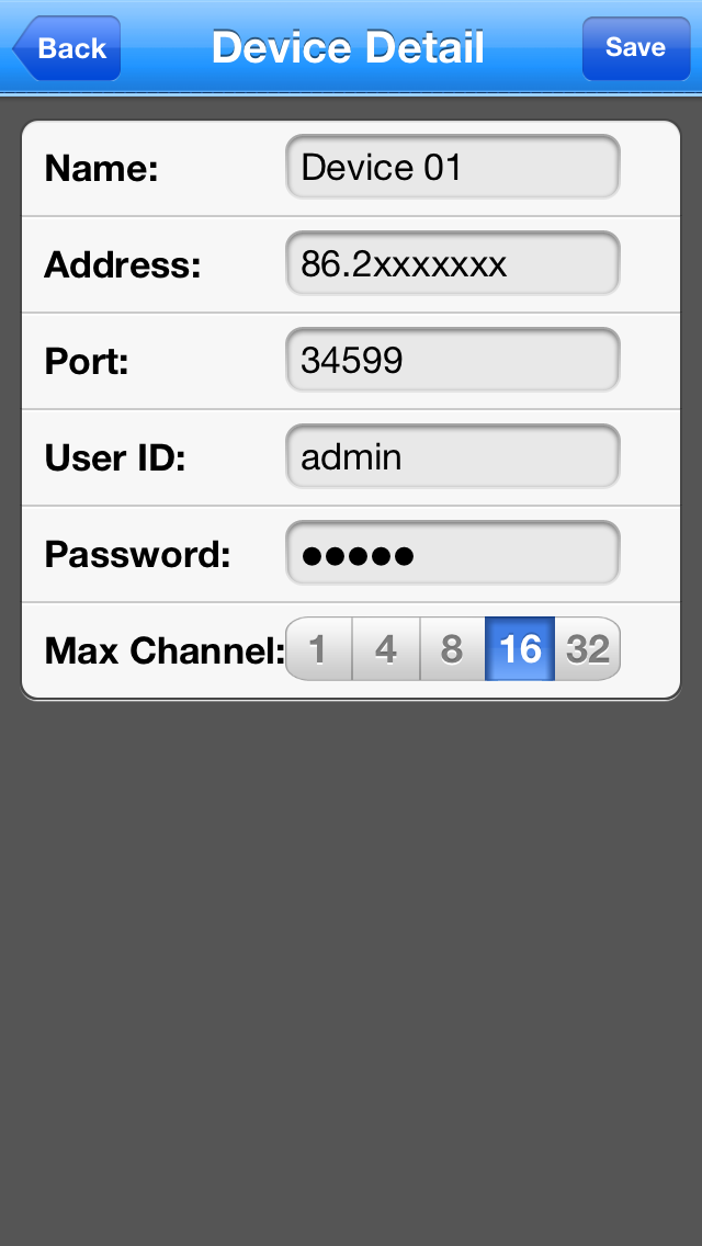

bootlegger 0 Posted September 15, 2013 (edited) Hi Guys; Just purchased a cheap generic CCtv system to go with my existing camera setup which was working fine until the box gave up the ghost. Its called H 264 DVR no badge or nothing the manual was in broken english etc Ive set it up ok and its all working and recording etc the remote view i can only see on a laptop or desktop on home network and away from home and its working just fine..... on the laptop/computers. I have a Virgin hub and have Port forwarded ports 100, 34567 & 34599 the manual suggests using KWeye which i used with the original setup up but once i put the settings in im getting no connection timeouts? the ip address is 86.27.**.185:100 admin admin can anyone suggest anything before i throw it out the window? thanks in advance Bootlegger Edited September 15, 2013 by Guest Share this post Link to post Share on other sites
tomcctv 190 Posted September 15, 2013 Hi. Best app for your system is MEye for both apple and android. Share this post Link to post Share on other sites

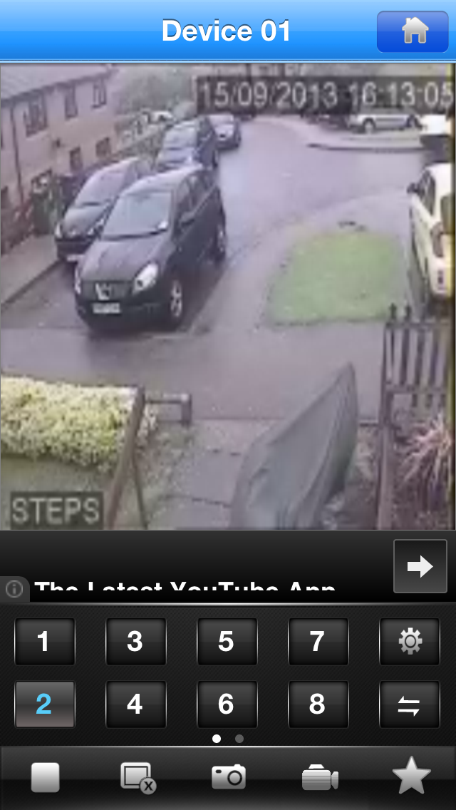

bootlegger 0 Posted September 15, 2013 Hi. Best app for your system is MEye for both apple and android. Can you please explain how you entered the settings as I've got Meye running but it's just buffering constantly?.. Thanks though, at least i know it can work.... Share this post Link to post Share on other sites
bootlegger 0 Posted September 15, 2013 Your a star! Working fine now, I had port as 100 ! Many thanks Much kudos to you ! Share this post Link to post Share on other sites
