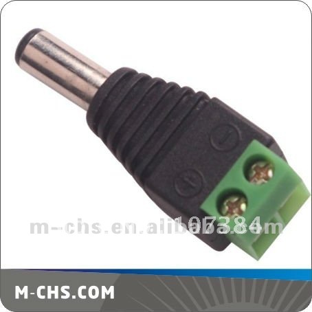

The width of these would be put together will be 1.6 inches minimum. Thats pretty big

Have a think about it ........ Why do you need a hole the same size of power and bnc together ?? Why not just the size of bnc.

best pushing one conector though at a time. so only need hole of the size of BNC which is the biggest.

If you are using Cat6, you should be using video baluns, anb not those BNC connectors. But if the image quality is fine, oh well...
I would be upset too if someone installed me some domes like that, those boxes do look ugly. I would rather have a biger hole (if the BNC can fit, the power connector will do too) and have the connectors inside the house.
