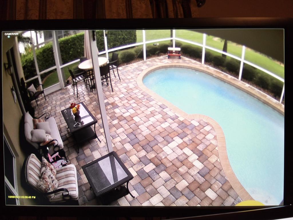

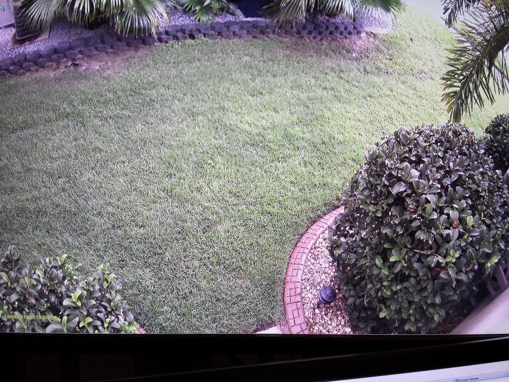

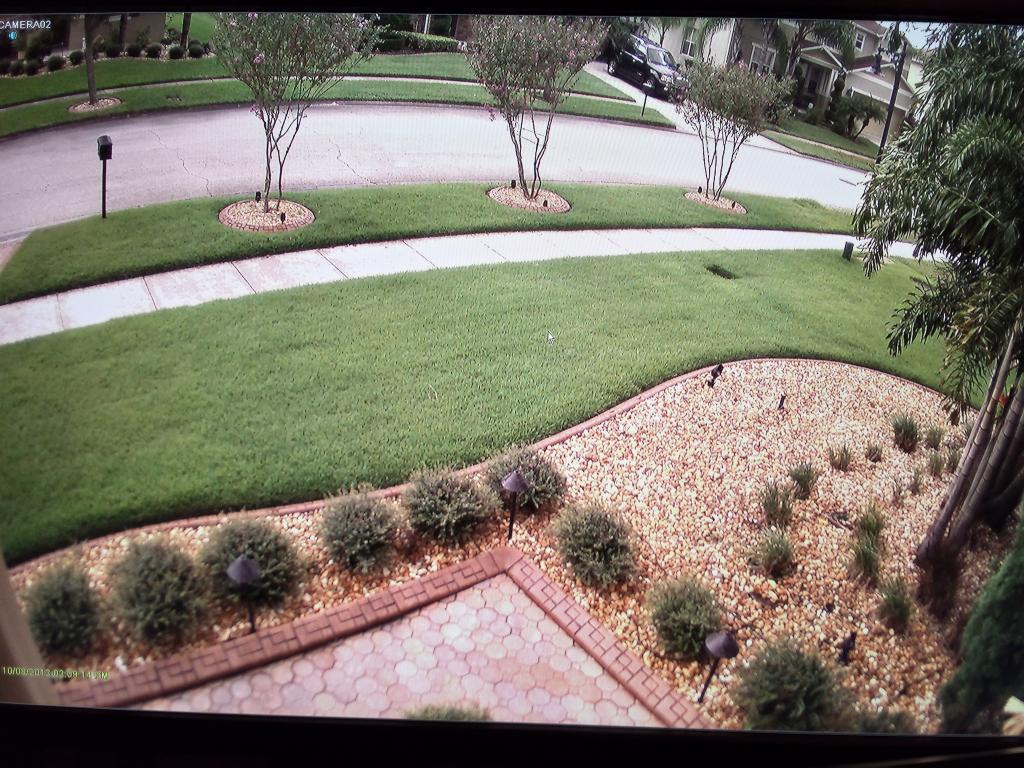

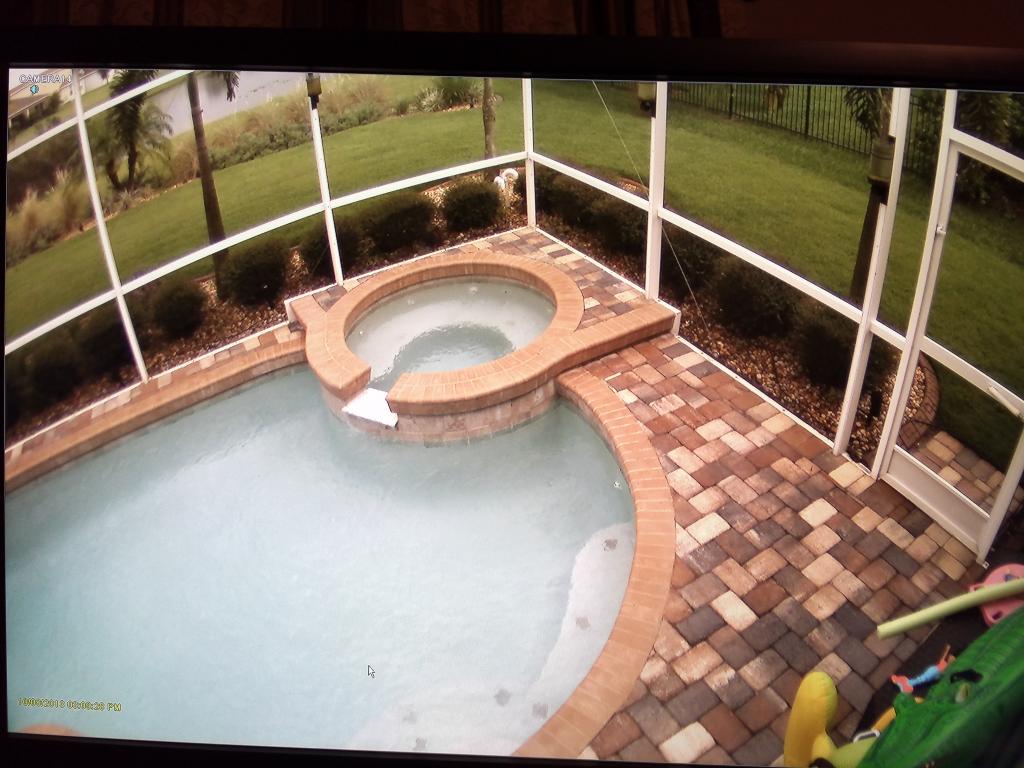

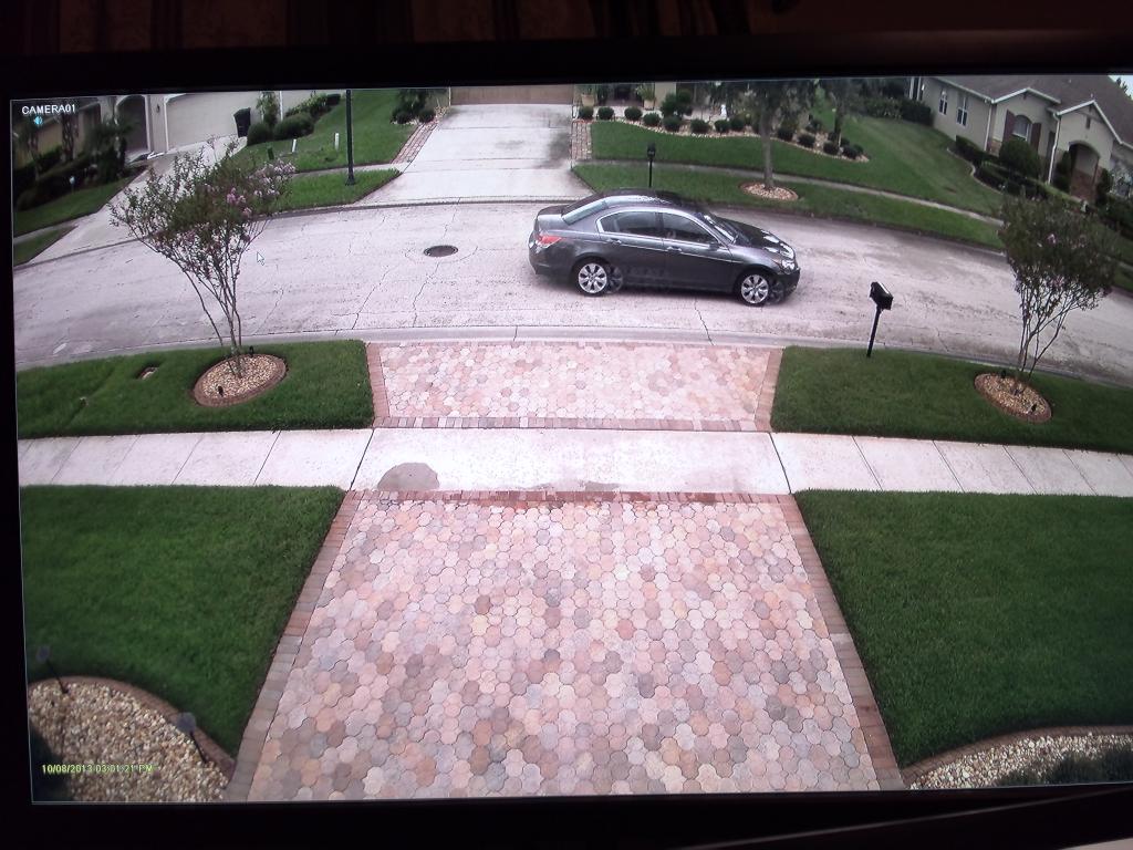

suzook 0 Posted October 8, 2013 Hey all Well I made the jump from D1 to HD-SDI. At first I loved it and now maybe I hate it. First some back story. I was able to procure 16 HD-SDI cameras from a trade group out of China. I they are a combination of bullet and domes, all vari focal from 2.8 to 12mm. Each has 48 ir pieces so should be good for 80 or so feet. I was able to get them for a sample price of $85 for each camera which is certainly a very low price. Along with it, an HD-SDI dvrthat was capable of both live view AND recording @ 30fps. Half my install was done this past week (buddy is a pro installer for 15 years and charges me $20 on the weekend for drinking money) During the install I was immediately taken aback when each camera was lit because of the color and clarity. I mean really impressive. I thought D1 was good well this was great. Then the reality set in. First off, the menus that come with the cameras are not easy to navigate and there is ZERO documentation so its been totally trial and error (and still much on the side of error as its stands right now) second, and this might be the trade off, the night image on this cameras is horrible, to the point my D1's actually look better. so now I am unsure of what to do. I didnt expect them to be 10x times better at night than my D1 but at least marginally better. We have checked all bnc and only used the highest grade wire and connector. Each line tones out with a tester as well. Is this just the limitation of HD-SDI or am I expecting too much. I peek in the IP section from time to time and see a lot of pics with night shots that look WAY better than mine. Frustrated doesn't even start to tell the story. Could adjustment in the menu help? I am open to all ideas and suggestions. Link to camera included http://sunivision.en.alibaba.com/product/730962258-218686411/_Factory_HD_SDI_Vandalproof_IR_Dome_Camera.html http://sunivision.en.alibaba.com/product/699878722-218686411/1080P_HD_SDI_Camera.html I have included some day time shots and will post up night shot later Share this post Link to post Share on other sites

shockwave199 0 Posted October 9, 2013 You're quite possibly comparing that image, one that is not total darkness in which the camera still has plenty of available light to produce an optimal image, to your cameras in true, total darkness. Not a fair comparison. Your day shots look great, but they seem a bit on the dark side. Was it a very overcast day? Really though, you need to post the night shots so they can be analyzed. We have nothing to go on otherwise. Also, adjusting menu settings without knowing what you're doing is like entering a forest without a compass or breadcrumbs to lead out back out. First let's see the night shots. Then it may be necessary to default the cameras back to factory default settings and start over, touching little to nothing. And if you do need to tweak a setting, you need to write down every starting point so you can get back if you need to. Menu tweaking very quickly leads you into a maze you can't get out of if you don't understand what you're doing. Been there, done that. But first...all your bad night shots please. And if you could, please embed the pics in your post so we don't have to fetch them manually. Share this post Link to post Share on other sites
