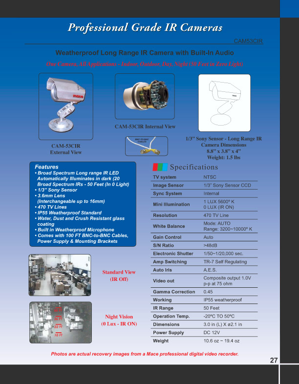

kandcorp 0 Posted December 29, 2005 NO not really...not for that price. You need something like Mace's Cam53CIR..They work great at night, 1/3 sony sensor, 470TVL, 3.6mm Lens, 50ft IR range, built in mic...Overall a good camera especially for night viewing. What is your budget for the new camera..under $200.00?? I would also try to stay away from EBAY.. Share this post Link to post Share on other sites

camera714 0 Posted December 29, 2005 hmmm the Mace's Cam53CIR looks good, think i might get that http://cgi.ebay.com/CAM53CIR-NEW-Mace-Weatherproof-Ir-Color-Camera_W0QQitemZ5648121238QQcategoryZ3204QQssPageNameZWD1VQQrdZ1QQcmdZViewItem Share this post Link to post Share on other sites
kandcorp 0 Posted December 29, 2005 Here is a little better price on that Mace 53CIR http://www.digitallyunique.com/cam53cir.html?src=247 Here are the package contents: CAM53CIR Weatherproof Long Range IR Camera with Built-In Audio 100 FT BNC-to-BNC Cables Power Supply Mounting Brackets Share this post Link to post Share on other sites
jisaac 0 Posted December 29, 2005 cam 53's are great for the price. One of the best affordable. I cant even count how many of those we have sold. Share this post Link to post Share on other sites
camera714 0 Posted December 29, 2005 well i just placed an order on the mace camera, hopefully it will turn out good . thanks for the link kandcorp. Share this post Link to post Share on other sites

camera714 0 Posted January 3, 2006 I just got the camera today, it didnt came with the 100 ft cable, do they ship it seperatly? Share this post Link to post Share on other sites
kandcorp 0 Posted January 3, 2006 It should have according to the place you ordered it from: Package Contents: CAM53CIR Weatherproof Long Range IR Camera with Built-In Audio 100 FT BNC-to-BNC Cables Power Supply Mounting Brackets You need to call Digitally Unique and ask them to send that cable because they do advertise that it is included. Thanks Share this post Link to post Share on other sites

camera714 0 Posted January 3, 2006 AHH!!! WTF I just found it they sent me the wrong cam!! i order CAM53CIR instead they gave me CAM43CIR!!! calling them right now Share this post Link to post Share on other sites
