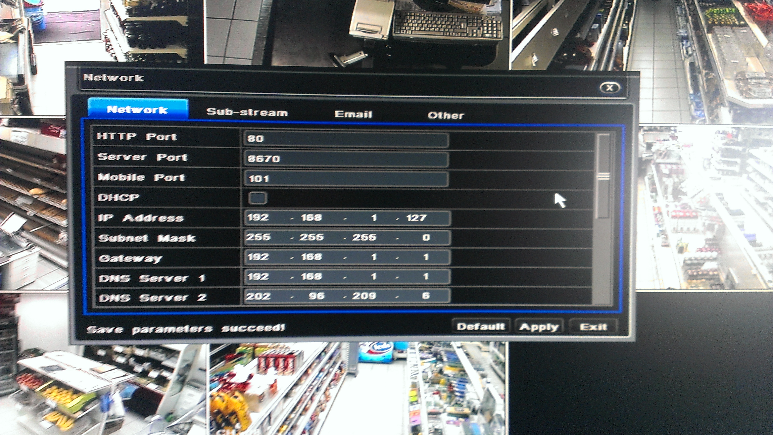

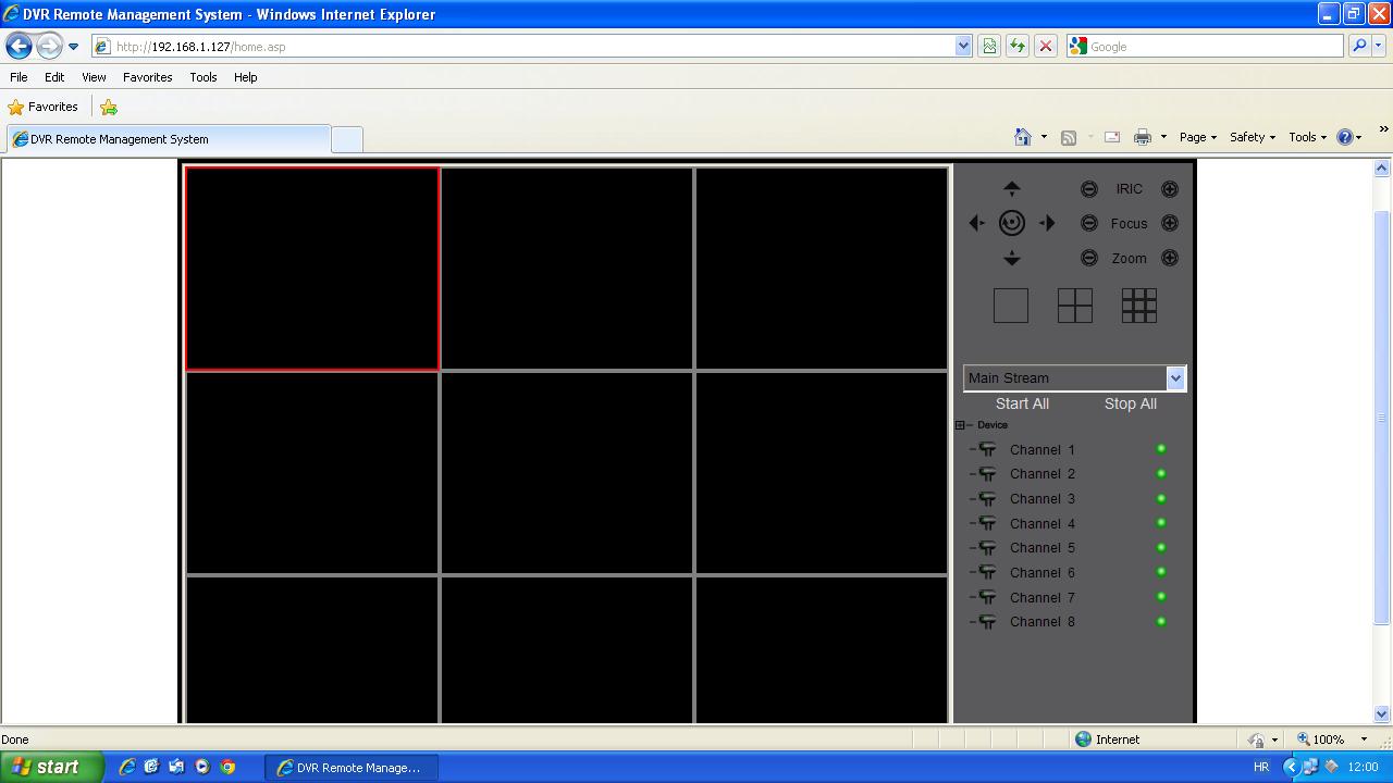

benko 0 Posted October 21, 2013 Recently got new DVR, just for analog part, 8 channels, 25fps per channel. Satisfied so far with it, picture quality good, playback smooth! Would like to get somehow that I am able to watch what is happening(so streaming channels) in network and on the Ineternet(using Andoird phone). DVR supports it(Android and iOS too), but user manual has really poor description. Maybe you can help a litlle. Here are settings After I enter IP adress in IE, I manage to connect, but only black windows, tried on Xp, IE7 and Win7 IE9, on Chrome plugin simply does not even work, same is with Android phone(says plugin needs to be installed, but plugin is only for IE) ! Here is screenshot for IE Share this post Link to post Share on other sites

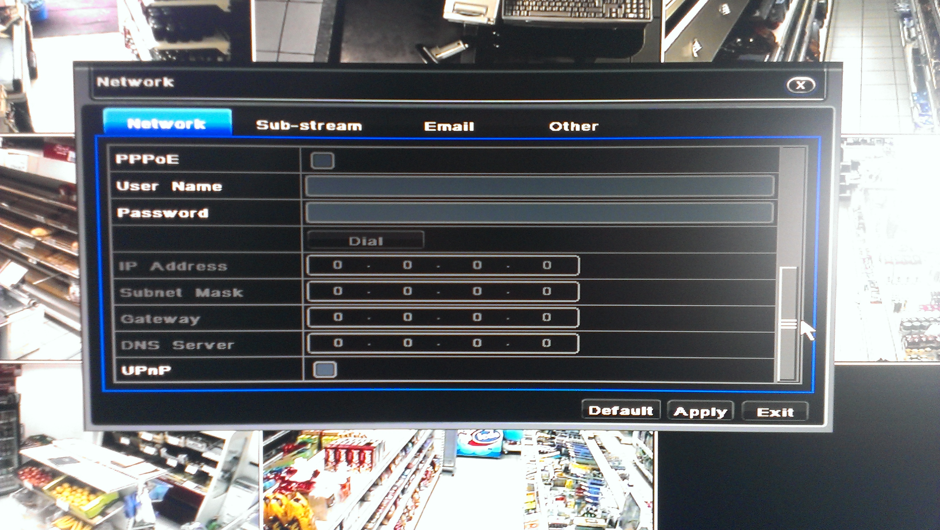

benko 0 Posted October 23, 2013 Not sure why but I needed to change IP adrees to any other. Now it is on 192.168.1.34(no need for port forwarding at all) and streaming via home network works excellent ! I even got it on my phone(MEyeprro app and TMEye app) Now question is, how to get it working over 3G on my Android phone ? I have tried enabling PPPoE and entering my username and password from my DSL provider but nothing happens ?!? So if you have ideas, I am widely open Share this post Link to post Share on other sites

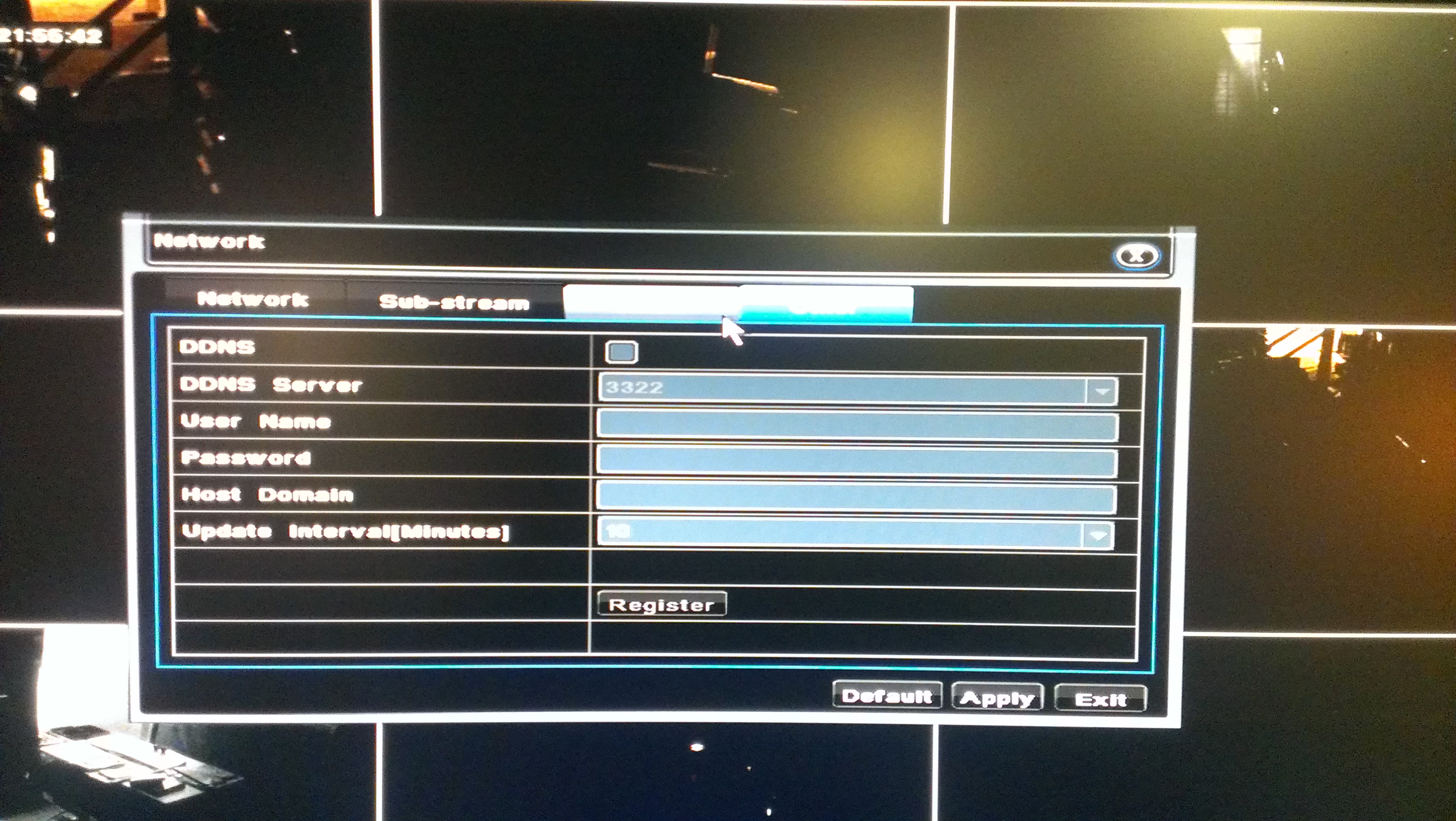

benko 0 Posted October 24, 2013 I can see it normally on any compuer/phone that is connected to my LAN/WLAN. Tried with 2 routers, Cisco and Thomson, both works same(they work, I can see live preview). So no problem with router ! And for mobile I am using 101 port) I "just" can't see it over any other netowork. So, as soon as I go off my network I can't acess DVR. That is normally, because when I am connected on collage's router of coourse that 192.168.1.34 will imploy nothing, siince DVR is not connected to that router. So how to get live preivew over Internet(not LAN/WLAN) ? I think I need to change somthing in DVR settings(pictures of all settings in first post), enable DDNS(yes my ISP changes my IP adress every 48h), PPPoE in DVR(if yes, what to enter in all those fields)? Share this post Link to post Share on other sites

benko 0 Posted October 24, 2013 I think you are confused. Its ok as you mentioned you can see video via any computer, may I know where are those computer does at same place with DVR? If YES, it means you are in LAN not WAN(Internet). Why you say your cellphone can see via APP, actually, I know that app and I think you just type of serial number on app. Those technology is called Peer to Peer ( Or cloud), not allow you connect your DVR true networking without louse set up. But if you did noy set up port forwarding and/or DDNS, its not able you to see via browser over internet. May I know where is your location? Ok, I am not confused, I just hasn0t described it well. So yes, watching DVR from any PC in LAN(though browser, entering 192.168.1.34) but not on WAN. Ok, changed port to 100 for HTTP, 101 for mobile and opened them in router. Now what's next ? Set-up DNS in DVR, here is shot of those settings Share this post Link to post Share on other sites
tomcctv 190 Posted October 24, 2013 Hi. I would leave a DDNS service till later and just use your external ip to get it all running first on LAN .... local you would be using 192.168.x.x but for away from your network ...WAN ..... you need your external IP click here will give you your external ip http://whatismyipaddress.com/ Share this post Link to post Share on other sites

shockwave199 0 Posted October 25, 2013 I'm confused where you're at now. At home within your LAN, you can now see video picture in IE and phone and that has been solved? To see your cameras outside you home- WAN- you will need to port forward 80, 8670, and 101. You should probably change port 80 in the dvr to another port such as 83 or 88 because many internet providers block port 80. In the dvr you will need to see what choices they give you in DDNS. Hopefully one of them is no-ip as it's free or at least, Dyndns. Then you'd need to set up an account at no-ip.com or dyndns.com and put your account settings in the dvr in user name, password, and host domain. Then outside of your network in WAN, in IE you would type in your no-ip host name- example benko.no-ip.biz:83 That's assuming you change port 80 to 83 in the dvr. In the phone, you would use for address, benko.no-ip.biz and for port you would use 101. In the dvr you should check your sub stream settings and make sure they are low enough that they stream well remotely in WAN, but aren't so low that the picture looks bad. You'll need to experiment with that. In LAN at home, you might get away with opening all 8 cameras in main stream but it would depend on your pc and how powerful it is to do that. Otherwise it may be better to open all cameras in sub stream even at home to avoid your pc bogging down. One or two cameras in main stream might be ok, but trying for all eight may be too much. But for remote viewing in WAN, always open sub stream. Hope this helps. Share this post Link to post Share on other sites
benko 0 Posted October 26, 2013 Thank you, thank you, thank you, THANKS everbody for help ! Yes, everything works. At first had problems with getting static IP (if I disable DHCP option in DVR router does not see a device, so was not able to get port forwarding). But thankfully router has otpion use same adress, so now even with DHCP enabled on DVR always is same (local) adress. Than problems getting port, but now it all works. So got DVR working on net (688x ports, where x is number that is depending on which intface you choose, mobile or http). I believe my ISP does not block 80 port, but never the less I changed it. After that registered at no-ip.com set-up parameters in DVR and it all works Share this post Link to post Share on other sites
