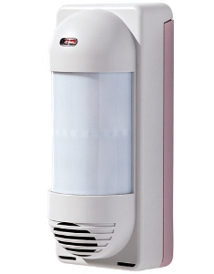

Look at adding PIR sensors to the alarm in ports. Google "Paradox PIR" or "Optex PIR". There are all kinds of detection patterns and levels of quality.

Hi. PIRs would work but still have false alarms or install a good PIR setup like a redwall unit.
if you want solid protection then optex beams ..... just 4 core alarm cable back to NVR

or another optex with custom added voice alert ..... same install just 4 core cable or go wireless video demo

Thank you... i am doing some homework on this. I will most likely get him a wireless PIR system with a loud speaker to wake him up and the intruders to go away.
Short answer to Tom's long answer- yes. Tons of options, but if the sensor is triggering a wake-up in the middle of the night then don't buy a $20 no-name indoor sensor and expect the anti-falsing and outdoor performance of a good name-brand unit. Anything is better than video motion based alerts in most outdoor locations though.
I was thinking a decent priced wireless outdoor/indoor PIR sensor.
Is there a brand you guys can reccomend? He just wants to be ablet o be alerted while he is sleeping even if may be a false alarm or not.
Thanks!
Optex is the biggest brand of the two I mentioned. If you want cheap and aren't stuck on it working with the nvr, just search Amazon for driveway alarm and read the reviews. You can get something crappy but functional for under $20. It will probably last long enough to catch the first few crooks anyway.
