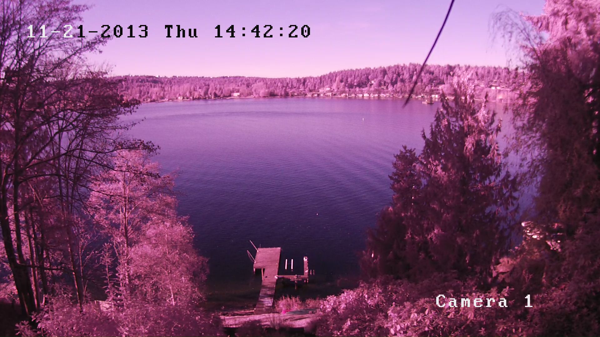

AussieInSeattle 0 Posted November 21, 2013 I have the Swann 7200 (8 channel/4 camera) system from Costco (purchased mid last year I think). I only have one camera setup at the moment - it was fine for the first month or so but now has a severe purple hue to it. I've tried: rebooting the 7200 rebooting the camera (after a lot of effort in trying to get access to them since they are on the recorders network) Any ideas on how to fix it before I call support? Image attached (I hope) of what I'm seeing. Thanks, Matt Share this post Link to post Share on other sites
MaxIcon 0 Posted November 21, 2013 Looks like your IR filter might be stuck in the out position. Sometimes a good thump or two will free it up, but once it starts doing this, it will probably keep doing it. Share this post Link to post Share on other sites
AussieInSeattle 0 Posted November 21, 2013 Thanks Max. I know what the IR Filter does, but dont know where it is - internal on the camera or external and what am I thumping? Do I have to do anything after thumping? Share this post Link to post Share on other sites

buellwinkle 0 Posted November 22, 2013 That is awesome, love the colors. Set the camera to day and back to nigh mode a few times, sometimes that unsticks it. Never had this problem with Hikvision, but can happen even on expensive cameras. Share this post Link to post Share on other sites
PaulfromCT 0 Posted November 22, 2013 I had same issue with a Q-See (Dahua) bullet, the IR cut filter got stuck. Never had that same problem with any of my Swann/Hikvision bullets or domes. If you spent a lot of time wiring up the system, placing cameras and programming the NVR I would call Costco and see if they will replace just the one camera (so you don't have to start all over). I have had nothing but good luck with Swann cameras in the past and this bad camera was probably just a fluke. BTW, that is a great view! Share this post Link to post Share on other sites

shockwave199 0 Posted November 22, 2013 Maybe try a different AWB profile? Share this post Link to post Share on other sites
AussieInSeattle 0 Posted November 22, 2013 Tried thumping, swapping day/night mode, different awb profiles and rebooting the camera all without success. Will swap it out with one of the ones I have not put up yet and see if I can get a replacement from Costco. Image looks fine at night so am guessing it is the IR Filter that is stuck. Regards, Matt Share this post Link to post Share on other sites
MaxIcon 0 Posted November 22, 2013 You should be able to hear the filter click in and out if it's working. It's not a loud sound, and best bet is to try with a camera that's working, then compare to the suspect camera. You can either shine a light in the sensor, then block it to make it switch, or have someone switch modes from the web screen. I have a Vivotek that switches in one orientation, but not when it's upside down, and you can tell the difference by a solid click vs a mushy click. Share this post Link to post Share on other sites
