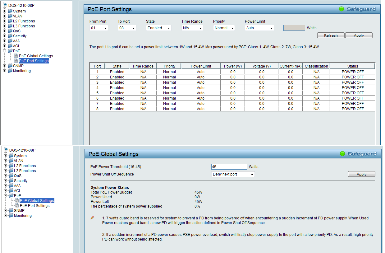

This is the POE settings page (or better said, the two pages pasted together in one image) from the dlink switch:

From what I can find, the IPH-WB3110 camera specs say that POE is "optional". It's possible that your camera does not have it installed.

Might have something to do with the (optional) part...
Thanks guys, yeah the "optional" part must be the problem...
But being new to this field, i had the doubt that i was missing something and there was some hidden config somewhere, either in the switch or the cam.
Thanks again.
Hi, just to say that it turned out the cam was missing the POE module, the guy from the shop tested his owns (from the same shipment) and he had the same problem, POE not working.
