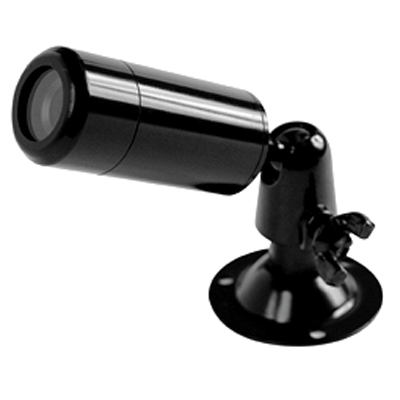

Yep i got DVR by itself and then got few mini cameras, as bunch of junkies/dealers around me, i think they sell drugs few houses from me, across the street, did not want them to think i am filming them...
One thing i dont like about dome and large bullet cameras with IR is that IR leads glows violet in the darkness and attracts too much attention.
I dont want to buy IR camera unless i know i can put some physical filter over IR and remove glowing.
I'd rather have independent IR source somewhere separate from the camera and have bullet cameras (without IR) as they are much smaller hence difficult to spot.
Like this bullet camera
However i guess its not going to work as this small bullet cameras same junk as spy cameras, they dont even list TVL where they sell them e.g. at VideSecu store
