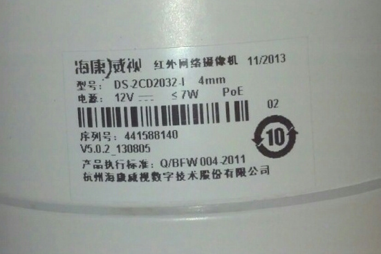

These showed up yesterday! " title="Applause" /> Their pretty small!
Sweet! Can't wait to test them out, been so busy it might be a couple of days though.
I see a 11/2013 at the top, but a 2011 at the bottom, assuming they were built last month?
It also appears their the 5.0.2 versions..
They are tiny and I opened one up and it's such a dense layering of boards, they certainly packed a lot into a tiny package.

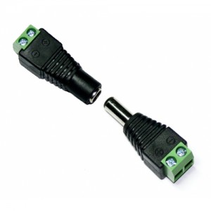

The Hik uses the defacto standard 2.1x5.5mm connector. If your PS already has these, verify the polarity, and you should be good. Otherwise, you'll need a connector for it.
When I'm doing short term power connections or testing stuff, I like to use these screw connectors:
http://www.ebay.com/itm/5Pair-Male-Female-2-1-5-5mm-DC-Power-Jack-Plug-Adapter-Connector-for-CCTV-Camera-/390720830006?pt=US_Surveillance_Cables_Adapters_Connectors&hash=item5af8c6ba36
Search for cctv power connector to see lots of options. You can get them from Amazon, too.
If they go outside, you'll need to protect them, but this would be true of any connection to the Hik's short pigtail.

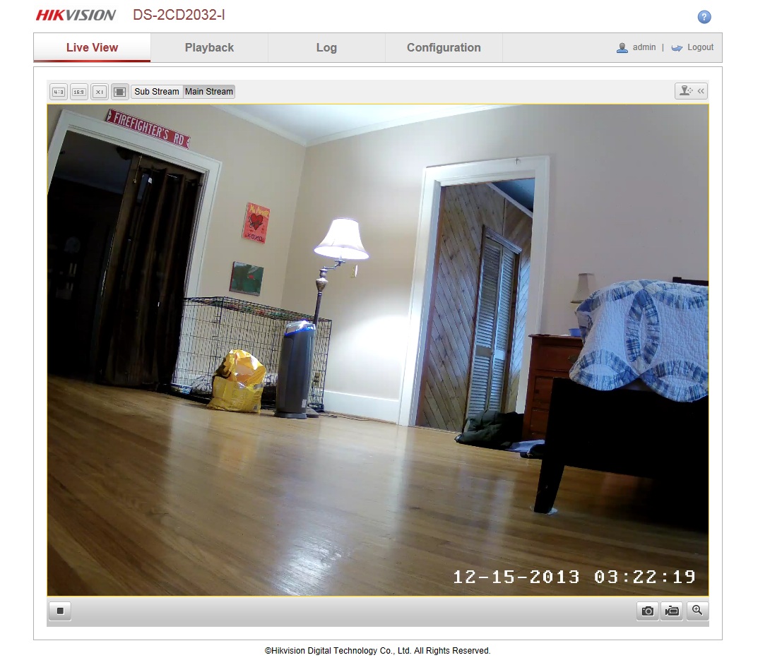

Just for testing, here's a screen Snap shot from my computer, not the camera. But it was nice just to see it working. lol

I'm just using the HikVision online viewer that comes with the camera.
Here are some shots from the "Caputure" option on the liveview.

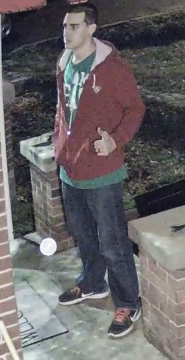

So here are two captures of me in front of the door, and then down the steps. So me close to the door is about 18ish ft away.
and the 2nd is maybe 24-25ft away. Roughly.
I'm 6'5", 220lbs.
Remember, It's 1AM and the lighting is from a florescent light flood bulb that is like a 20w bulb.. the exposure is set to 1/25 because it's either that or 1/50. No 1/30 as I've heard is a common choice.
And me cropped from the photo. I feel pretty happy, since it's night. I'm hoping to get a better photo durring the day time.

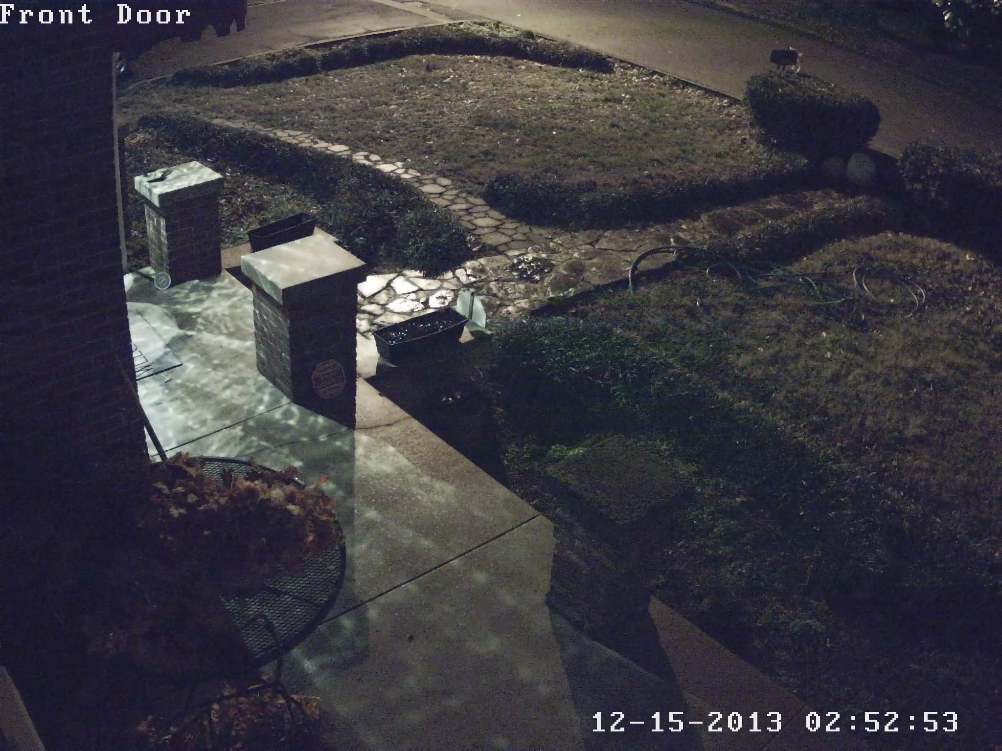

Also, here are some night shots with the outdoor flood bulb off... Only street light and a 5W LED fixture at the front door that
it almost useless because it's cracked glass giving a very bad light off put for cctv. Just for looks.
No IR, DAY Mode with No Flood Light.

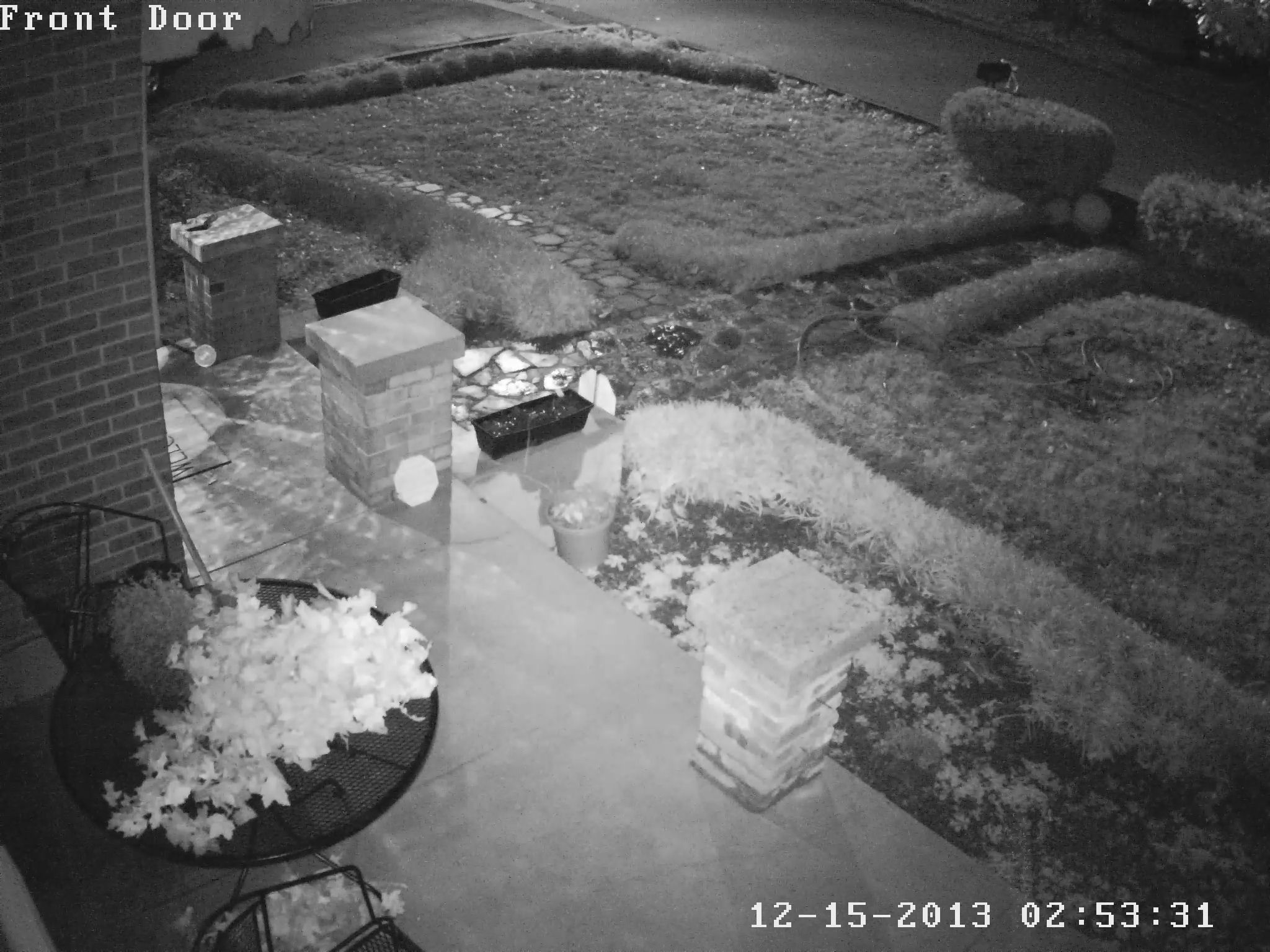

IR ON, Smart IR OFF
IR ON, Smart IR ON
