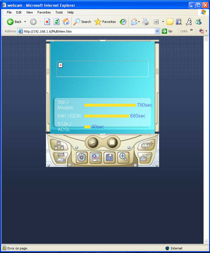

jgsx 0 Posted January 8, 2006 (edited) I am using a legit GV-600 card with Geo ver 6. I am having trouble with all of the web features. I can get Mpeg4 Encoder View and Remote Play Back to work on SOME of my local comptuers, but not all. All of the computers that I am testing this on are local computers with IPs 192.168.1.x, and have no fire walls. All computers are XP with SP2. I already changed my security settings by In Internet Explorer. Select Tools, Internet Options, Security. Select Internet, then click on "Custom level". Change the following options : Automatic Prompting for Active X controls - set to "enable" Download Unsigned Active X Controls - set to "Prompt" Initialise and script Active X controls not marked as safe - set to "Prompt" That allowed Mpeg4 Encoder Viewer and Remote Play Back to work on two PCs. One three PCs, I get stuck in a loop. When trying to use Encoder View, Live.cab installs fine, and I am able to select DSL/Cable/T-1 and Multiview. The next step, it asks to install DownloadFile.cab. I click install, then after a few seconds, IE stops and says Error on Page. I have tried purching the cache and history, but nothing seems to do the trick. I searched the forums but wasn't able to find a solution to this. Any help would be greatly appreciated. Edited January 8, 2006 by Guest Share this post Link to post Share on other sites

rory 0 Posted January 8, 2006 what error are you getting .. is it on the bottom left .. can you do a screen shot of the page ..? Share this post Link to post Share on other sites
jgsx 0 Posted January 8, 2006 what error are you getting .. is it on the bottom left .. can you do a screen shot of the page ..? Sure, here's the shot Share this post Link to post Share on other sites
rory 0 Posted January 8, 2006 ok forget multicam for right now, does the single or 2 way view work ...?? My software doesnt install Multicam, which is a seperate program and not that stable anyways .. Share this post Link to post Share on other sites
rory 0 Posted January 8, 2006 double left click on that error at the bottom, and let me know what it sais .. which line is the error and if it gives any detail, you can do a screen shot of that too if you want, or just let me know what it sais .. thanks Share this post Link to post Share on other sites

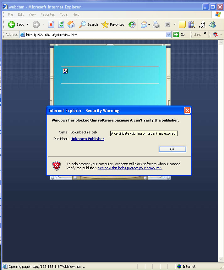

jgsx 0 Posted January 8, 2006 With that disabled, the box still comes up asking to install or Don't Install It shouldnt, did you set the Security Settings to Default? Also, click on the Programs Tab - RESET WEB SETTINGS Click on Advanced Tab - RESET DEFAULTS Ok, this is the install prompt that I now get When I try to Reset Web Settings, I get an error 'Unable to reset Web settings' Share this post Link to post Share on other sites
