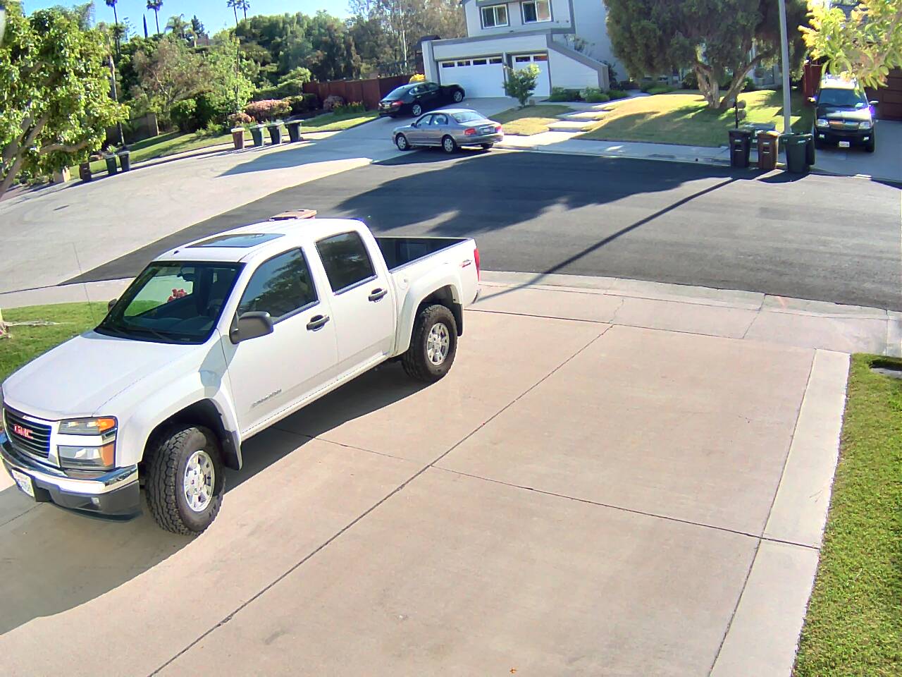

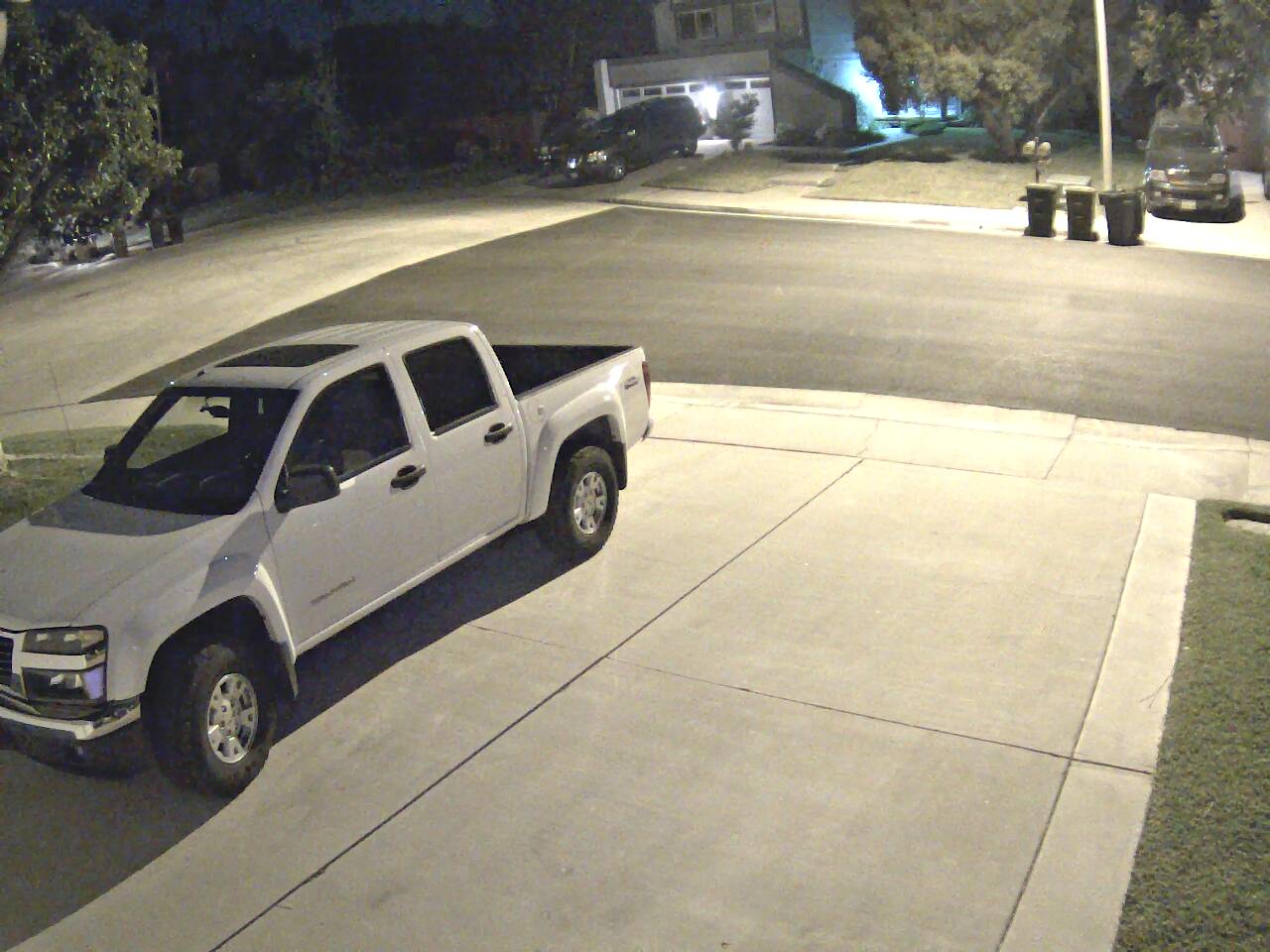

Just wanted to show you an Axis Lightfinder camera from one of my reviews. This is the P3384-VE, same as P3364-VE but has WDR which you don't need. This is in my driveway, no other lights other than street light across the street. If this was an M24 or M25, it would be black with a slight glow in the general direction of the street light. You say you don't need low light performance, but those pictures from Lake Louise are dark even during the day. At the slightest sense of sunset they get very noisy.
This is the same shot but during the day, you can click on the pictures to see the full resolution shot.
Nice night image. What lux level or approx time of night was that taken? What resolution and frame rates do you get with that camera?
