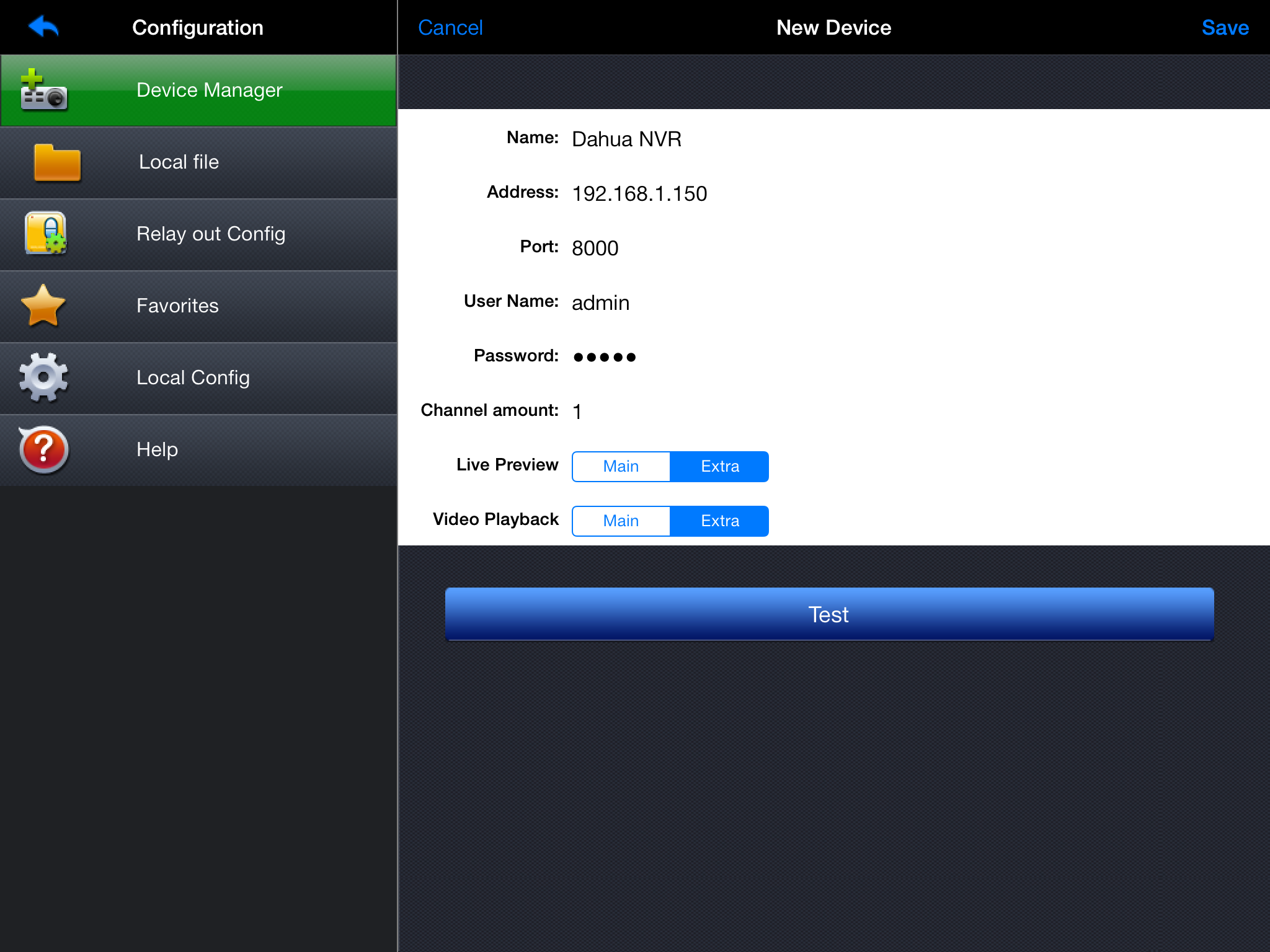

I must be doing something wrong then. I have both a Dahua NVR and a Dahua camera. When I try to connect to either one with IDMSS I get "Time is out". This is the lite version, I would happily buy the full one if I thought it would work, but surely the lite version should at least show the video ?

FYI...the port your are using on the IDMSS app goes with the TCP port on your NVR. The default is 37777 on the NVR unless you changed it(I would leave it 37777).
Is your TCP port 8000 in your NVR? By default it is 37777, so unless you changed it, that is your problem.
Yes. As I've already said it works with IE, Blue Iris, Security Spy and DComplex so something as basic as that I have done. I don't use the default as I have a convention for the ip address and ports of all my cameras as 192.168.1.15x and 8xxx, and use the base addresses for the NVR.

In your NVR setting, what is your HTTP port and what is your TCP port? This last comment you mention 8000, but that is only one port. As you have mentioned repeatedly, it works in IE and blue Iris, but that is a different port than a mobile device uses. Computers use HTTP and mobile devices use TCP on Dahua NVR's.
For now, forget about anything IDMSS Lite and put it down. Physically go to you NVR and make sure the MAC address and Gateway are set for your router on the NVR(hook up a display to either a tv or computer monitor via hdmi/vga port). If these are not configured then no matter what you do, it will not work. I am not saying port forward anything on the router. Next, while still at the NVR see what your TCP port is set to under Network settings. Write down whatever port is in the TCP section on the NVR. The Dahua NVR will not work on your network using the TCP port if the default gateway and MAC address are not set. (you can quick set it by changing to DHCP and restarting your NVR then change it back to Static with whatever IP address you want)
Go to IDMSS lite and input whatever port was in the TCP section of your NVR into the IDMSS Lite app as the port. (NOT the HTTP Port.....If you are using IE to log into the NVR with the IP address of 192.168.1.150:8000 then 8000 is your HTTP port and NOT your TCP port)
If this does not work then you are either using an IP address out of range or something on your system is blocking the NVR. I have set up dozens of these on dozens of different routers. The TCP port is different from the HTTP port and from your description I think you have those two confused. Take a picture of the Network page on your NVR and post it up if this does not fix it.

You were right and I was confusing TCP and HTTP ports. I now have it working on an iPad although for some reason I can't get it working on my iPhone, although I am sure this is something and nothing.
