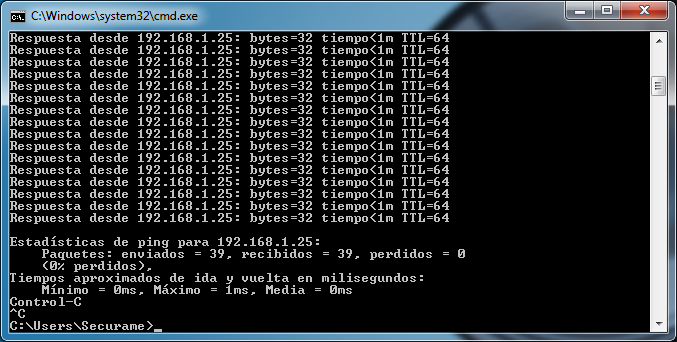

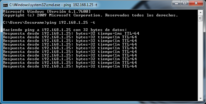

Securame 0 Posted January 8, 2014 Well, the fact that the camera says that there is some problem with the network is not a good sign. Open again a DOS prompt (start, run, command or cmd) and instead of doing "ipconfig", do a "ping 192.168.1.64 -t". That pings the camera until you tell it to stop. Let it ping for a couple minutes if you want, and finish with CTRL+C. You should have no packet loss and ping times of about 1ms, something like this. What are the specs on that computer? Maybe it is way too old to be able to handle a 1920x1080 video stream? Share this post Link to post Share on other sites
empedokles 0 Posted January 8, 2014 I seem to get the same. Intel Core 2 CPU 6300 @1.86GHz, 1.58GHz 0.99 GB Ram The cable which leads to the router is by the way cat5 and not cat5e. Is that a problem? Share this post Link to post Share on other sites
