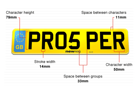

could I do it with a 12mm lens, or bigger? I live in the uk (fairly large reg plates)
I should add - the cars will be stationary, or moving slowly.
On a 4CIF/D1 analog camera you'd need atleast a 15mm lens to be able to read a reg plate. But you will also need to well target the camera because the scene you will capture will have a width of 10 feet.
