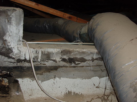

After reviewing my photographs of that area in the attic I know why I avoided mounting that way.
There appears to be another 2 feet of solid concrete above that beam.
Plus there is Heat/AC duct work covering that exact area.

This is what I will have to drill through and avoide electrical conduit and Duct work. No fun. Especially for so little pay. like nothing.
It would look much more professional though and would allow optimal placement of the cameras.
This place has been remodeled three times. So there is roof over roof.
Makes for an interesting install

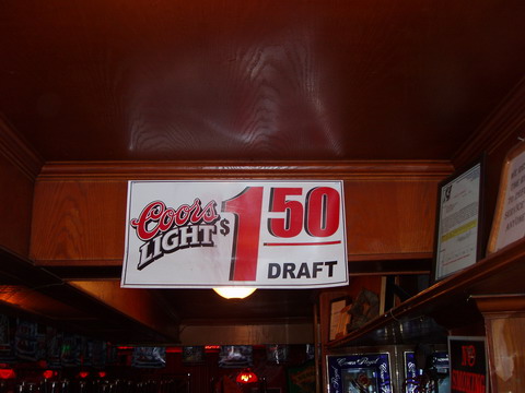

I ended up coming down from the ceiling on the other side of the beam, just to the side of it.
He didn't want me to go through the beam. I put them in after closing last night.
He didn't mind the cable showing. The draft beer sign was put on the other side of the beam to cover up the cables.
