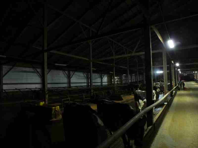

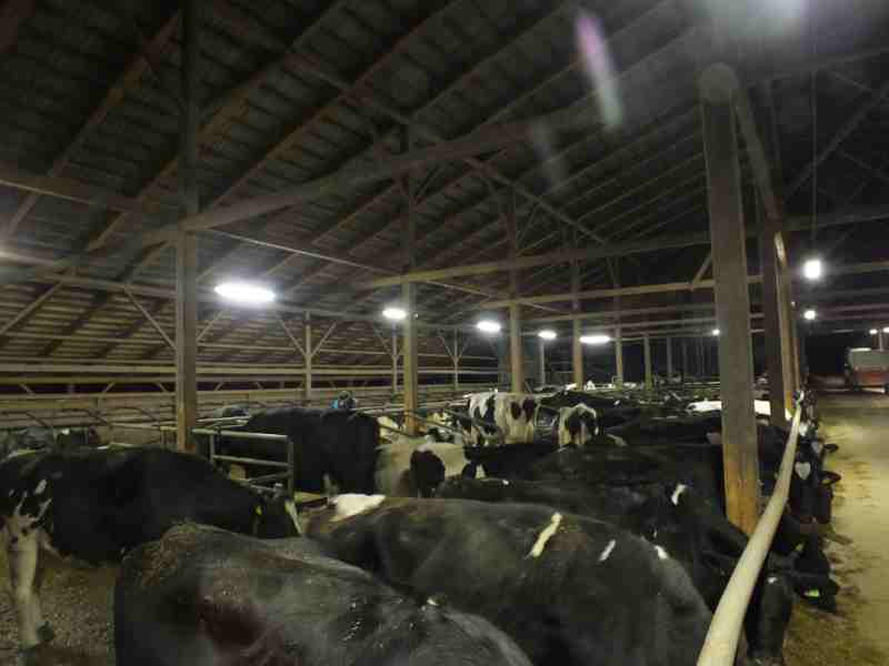

robert 0 Posted January 16, 2014 (edited) Guys, I need to quote a customer with cow farm(under a roof, indoors), 18 cams. They have office room where recorder will be located. Few cameras will be nearly 200m away from DVR. They have no preference - IP or HD-SDI, they simply need good quality images, 1.3mpix or 1080p. I`m leaning towards IP system because: 1. PoE, no need for separate power cabling as for SDI cameras. Huge saving cost considering size of farm and meters of power cabling it would need. 2. I can easy extend PoE for long distance cameras with Veracity PoE extender. 3. Wide range of reasonably priced and good quality cameras. 4. I`ll be using Luxriot and will have direct support from them. Luxriot guys will help me calculate PC/server spec I need, so that`s not an issue. I just wonder if HDD will be able to handle such amount of data recording Because all cameras will be on motion detection, they won`t be recording at the same time, therefore bandwidth should be ok for 100mbit network, as H264 1080p cam at 12fps produces about 7mbps. But then - which CPU will be able to decode H264 for live view for 18 cameras? Huge decoding power required. Or live view will be second stream - JPEG. But what will happen to bandwidth them? Need to talk to Luxriot on this. Looking at Arecont Vision MegaDome 2 domes or MegaView 2 all-in-one solution cameras. Need WDR, indoor & outdoor cams, with varifocal lenses. Some areas are poorly lit, might need to use cameras with IR lighting(PoE might not be able to handle IR). Because its farm, would there will be lot of flies/bugs attracted to IR lighting coming from cameras? I`m trying to explain them - install decent lighting and we won`t need to use IR cameras or illuminators +its visible to human eye. Guys, what do you think? Does this all sound right or have I missed something? Thanks! Few images from farm: Edited January 16, 2014 by Guest Share this post Link to post Share on other sites

skomo 0 Posted January 17, 2014 I've had experience installing cameras in a similar situation. It was a horse stable. It was probably 4-5 years ago. I used the Samsung IR Bullets and the bugs and spiders loved them. If you can not use IR, it would be best. Get cameras that are IP66+ rated so cleaners can literally hose them down if they get too dirty/bug covered, and also have the cameras in a reachable location so if the hose doesnt clean them, a cloth and spray can easily reach. As for NVR/Cameras, i do recommend Avigilon, due to the easy playback. but you could mix in the hikvision dome cameras, great bang for buck. If price is an issue you could look at Acti, they should be able to do the over 16 camera software for free if it means they get the job, or even LG have a free IP VMS for their cameras... Hope that helps Share this post Link to post Share on other sites

buellwinkle 0 Posted January 17, 2014 I would definitely go with non-IR domes. The problems I've had in the past with Arecont is poor support and not very good low light sensitivity. The Axis P33 series is very nice, good low light performance, remote focal length and focus adjustment, good warranty and support and just about all NVR software supports their cameras. The P3367 is my favorite, very good low light performance for a 5MP camera. Also, their Lightfinder cameras do very well with available light. Don't know how cattle feel about white light vs. IR. Some animals may have their sleep disrupted by IR as much as with white light so maybe check with a veterinarian in the area. If you can get away with white light, putting in some white LED fixtures is way less expensive than IR fixtures. I use Raytec products, they do make a PoE product but you'll pay a premium for it and you are limited in your choices. ACTi is a good choice too, about 1/2 the price of Axis/Arecont, and very good support and service and has a very good selection. You may even want to consider their new mini-PTZ that should be out today. They are relatively inexpensive, 10x optical zoom, small in size for a PTZ (a little larger than a regular outdoor dome) and run on standard PoE and come in various resolutions. It may be able to replace multiple cameras in locations where continuous monitoring is not critical. ACTi is supported by most NVR software solutions but also has a very good free solution that I feel would give Luxriot a run for it's money and now supports non-ACTi cameras. They charge for non-ACTi and cameras over the first 16. The Veracity extenders are very good, never had a problem with them and priced well. Share this post Link to post Share on other sites
