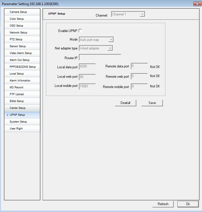

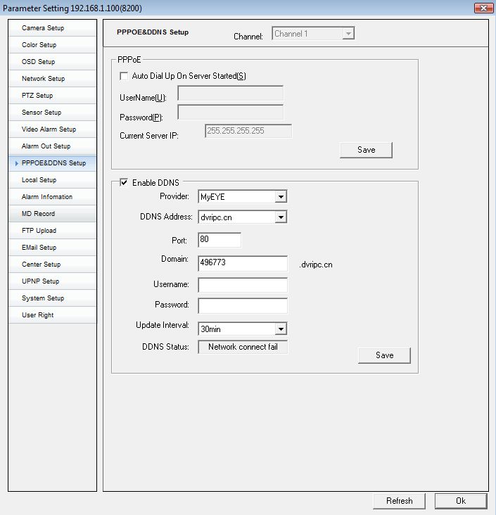

Here are some screenshots of the settings options in the cam's UI. Can you figure out from this what ports need to be opened?
If more than 1, can I also change these ports from within this UI or is that always the same?

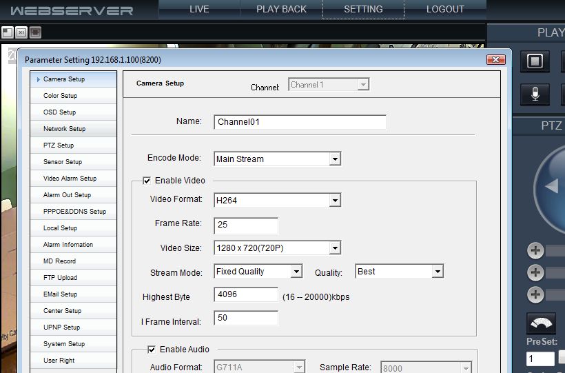

Here's another screenshot. Question, why does it say Webserver? Is there any specific settings due it seems to be running some kind of web server?
IP camera's bascially run tiny servers feeding the video out.
I'm assuming you are trying to xxxx.dvripc.cn? This throws up activex download for me just to login. That would likely explain why it's not working on android if you need that just to login.
Your screenshots are also showing:
"ddns status: network connect fail"
Well I do not want to use DDNS so I tool that away now. Still do not work.
The port I forward in my router, does that have to be maintained in the cam's interface, or are those ports something else?
What I do is change all the port numbers in the camera config to consecutive numbers, say 5000, 5001, 5002. Then open range of ports like 5000-5002 to the camera's IP and that usually works. Doesn't matter what the ports are for, sometimes it just needs them.
