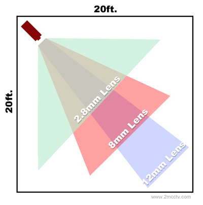

pipabix 0 Posted February 8, 2014 would like to start at 2.8, as im using it for home cctv, and just need roughly 10meters out from the house. Share this post Link to post Share on other sites

buellwinkle 0 Posted February 8, 2014 Yes they do, the 3MP ds-2cf2632f-i, is 2.8-12mm varifocal. Share this post Link to post Share on other sites
Heuer 0 Posted February 9, 2014 I have Hikvision dome and turret in 2.8mm and unless you are concerned about vandalism my recommendation would be the turret DS-2CD2332-I with EXIR because it can be tilted and adjusted to any angle (it is essentially an eyeball). It also does not suffer from IR bleed and the IR light is extremely powerful. Bear in mind you will need the associated (expensive!) mounting bracket DS-1239ZJ-1 if you can't mount it direct to a ceiling or other horizontal (ish) surface. The VF cams are OK if you can't decide what field of view you need but that adds to the cost and you lose some image sharpness. Share this post Link to post Share on other sites
