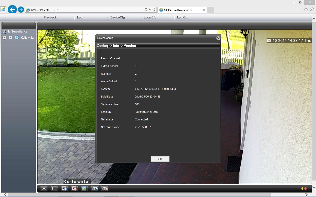

5. For the time setting please follow the attached picture. We have a sample of the camera you have in the office

Yes understand the camera firmware is a little different but I now know the original manufacturer. The motion detection will work after you upgrade it.
I now understand what you meant about the alarm in function. This only works on our other model which has a RS485 port. Software of all our NVR is same so if you are using the MINI NVR, don't bother to use this function.
