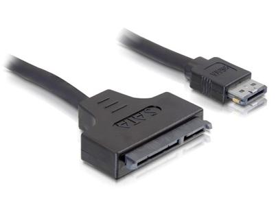

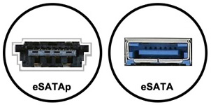

brazsik 0 Posted February 18, 2015 Hi Guys! Does the mininvr has eSATAp or eSATA port? I am not sure which cable would be the best - as you wrote, esata hdd connection would provide better stability than the usb one. Thanks! Share this post Link to post Share on other sites
GhostRider 0 Posted February 18, 2015 Have you tried changing to 4 camera or 8 camera view? I have the same problem on bith my nvr 1 and nvr2 8ch, unless i change to 4 cam view i cant view live streams jmemannix said: Hi, I have just received a Mini NVR 2 (16 channel) and I am trying to add my 9 IP cameras (IPCC-B12N). I add the RTSP links for each camera (rtsp://:/11) for the main stream but the window for the camera turns black with a flashing exclamation mark at the bottom. If I double click the window the video shows up in the large single video. If I add the sub stream (rtsp://:/12) they show up no problem. Ive tried adding them as onvif but the same applies as the above. Firstly does anyone know what the flashing exclamation mark means and does anybody know how to combat this problem. my old escam 8 channel Mini NVR had no problem showing the video with either the main or sub stream. Thanks Share this post Link to post Share on other sites
GhostRider 0 Posted February 18, 2015 Its standard Esata not p brazsik said: Hi Guys! Does the mininvr has eSATAp or eSATA port? I am not sure which cable would be the best - as you wrote, esata hdd connection would provide better stability than the usb one. Thanks! Share this post Link to post Share on other sites
