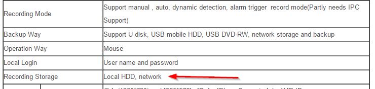

kenhas 0 Posted June 4, 2015 I bought the Escam branded mini NVR. Have to say I had no trouble at all adding my three Y-Cam camera's. At the moment I let the camera handle motion detection and save the stream to my server. But in the product specifications it says But I just can't find the settings for recording to my server. I assumed when the Escam website says you can use a network storage, it would be possible to do so. Can anybody confirm network recording is not possible ? Pretty useless device (to me) if that was the case Share this post Link to post Share on other sites
CharlieB 0 Posted June 5, 2015 Network recording is not possible, i also bought with plans to network record but had to settle with a attached drive Share this post Link to post Share on other sites
kenhas 0 Posted June 6, 2015 Ok, thanks for this disappointing answer Maybe one of the linux experts can answer this but would mounting a network share as a drive be a solution, fooling the NVR software? I have had a little bit of experience with command line linux via putty but not sure if this is possible. It would be harmful for bandwidth but with only three camera's it shouldn't be a problem Share this post Link to post Share on other sites
