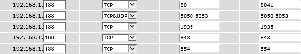

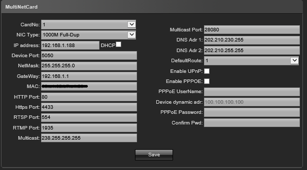

@Derek L. you need the following ports for the NVR to work out of home with or without the activeX plugin...
** I am just changing the 80 port to listen to 8041 from out..
I have copied your settings but I still do not get any video showing from a remote computer. the web GUI can be accessed but no video plays.
Check for proper installation of rtsp plugin.. Maybe some settings doesn't allow it to run.. Check if enabled or reinstall... Mine works fine from Mozilla or IE on windows 8.1 and from goo link software on iOS
