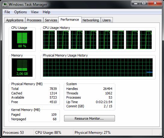

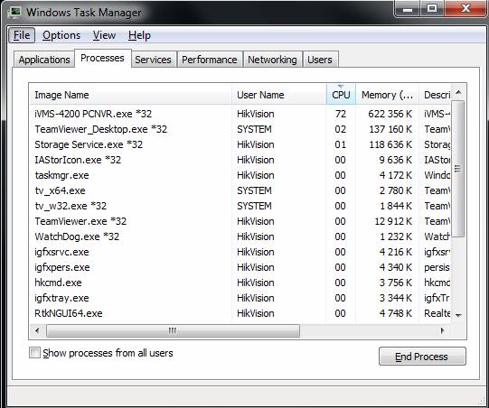

marizo 0 Posted February 13, 2014 Hello! At 1st I need to say I've deployed about 5 PC based NVR systems with 1 to 15 IP cameras and 2 systems based on Hikvision NVR DS-9616. Cameras used - Hikvision DS-2CD2032-I, DS-2CD2132-I, DS-2CD2012-I. So I think I have some expierence with networks, cameras and DVRs. Recently i'm stuck with one PC-NVR.. The situation is sad there are powerful and expensive PC: Intel i7-4770 @ 3,4GHz (integrated GPU HD 4600), 8GB DDR3, ASUS B85-PLUS MB, WIN7 Pro 64bit and 9 cameras DS-2CD2032-I The software installed Hikvision iVMS-4200 PCNVR v1.03.00.04 (Windows) and there are 90-100% processor usage when viewing all 9 cameras online and I'm sure it shouldn't be so. Last summer I set up CCTV system with 15 cameras and computer was weaker ( if i remember it was one of i5), but there was no problems. I think there are some iVMS incompatibility with 64bit system or i7 processor or GPU. Or I should add some GPU card to PC? I have no IDEAS. Maybe other members have any suggestions? Thanks a lot! Share this post Link to post Share on other sites
varascope 0 Posted February 13, 2014 Can you post a screen shot of your process tab? Also a screen grab of your running cores? Also, I would never recommend using onboard video. For video surveillance it is just bad practice, I know some will argue that it works but in general it is bad practice and not recommended. Traditionally an analog system offers live video of the bus. IP since it is compressed at the camera, the server than has to transcode the video in order to offer a live view. For smaller systems we found the ATI 6450 2GB card outperforms the NVIDIA. Especially if you are using software from overseas, the ATI has had better performance, from years of experience in strange and inconsistent issues related to the video card. Share this post Link to post Share on other sites
marizo 0 Posted February 13, 2014 There are some shoots from that system: I'm too thinking about onboard video.. but using it wasn't my idea. It seems to be solved using lower frame rate for cameras (not default 25 fps). But it lowers framerate in recording too. Its reasonable price for 6450, maybe it worth a try. Another idea was to ask Hikvision support some advice.. Now-one knows about their software more than they. === Today i tried some of that cameras in BlueIris software on another PC - result is the same.. It uses too many CPU to decode many 1920x1080p h264 streems.. Share this post Link to post Share on other sites
varascope 0 Posted February 13, 2014 Another idea was to ask Hikvision support some advice.. Now-one knows about their software more than they. . Let's just say OK for now. But let us know how that goes. I've found the answers are generic or vague. Can you try increasing the paging file. Minimum should be double the memory space. Also under performance, Click on Adjust for best Performance. I also use a 32GB SSD Caching drive the increases the performance significantly. Please send screen shots after the paging file change and adjust for best performance. Share this post Link to post Share on other sites
