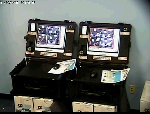

kandcorp 0 Posted January 16, 2006 This is what we use for our portable demo cases. We fit the PC DVR, 4 Cams, LCD monitor, and all the cables inside. You could probably use the case to keep the DVR/Monitor in. They get pretty warm inside with everything on. You could probably custom make a Port hole for an exhaust to keep moisture down. I dont know....Just thinking out loud. Share this post Link to post Share on other sites
