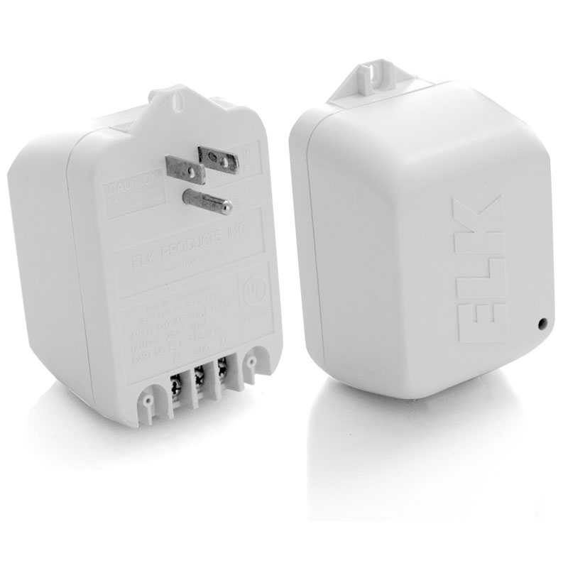

jingo 0 Posted March 8, 2014 Have a look at the pic`s on this box - is this what you are after: http://www.ebay.in/itm/ELK-TRG2440-24-VAC-40VA-Transformer-Power-Supply-/390435551766 Share this post Link to post Share on other sites

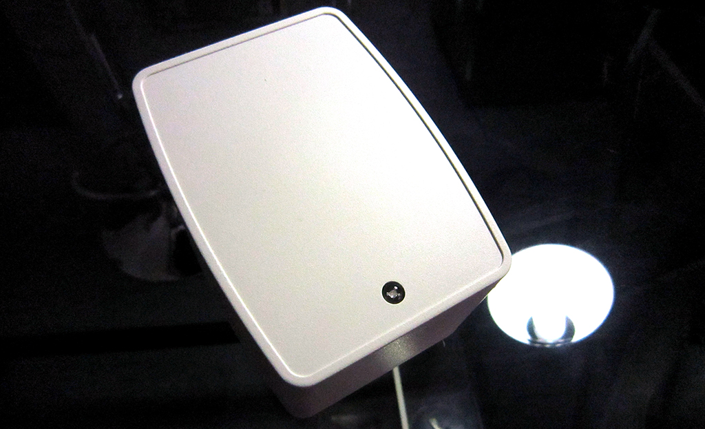

Mr. Anonymous 0 Posted March 8, 2014 Oops wrong photo, this is the photo from the listing Share this post Link to post Share on other sites

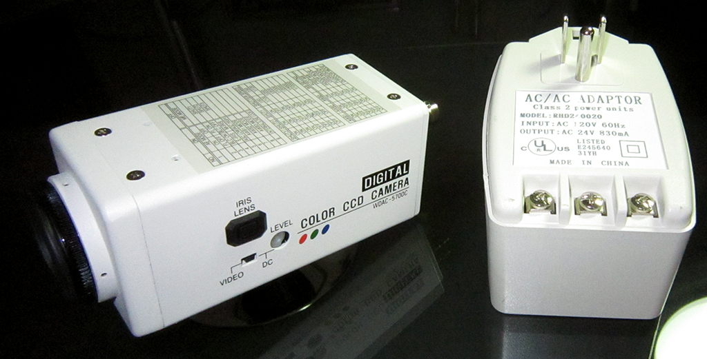

fertilebert 0 Posted March 8, 2014 It is an AC adapter, so it doesn't actually matter which way around you wire this , connect one wire to one AC terminal and the other wire to the other AC terminal, the middle terminal is your ground. Share this post Link to post Share on other sites

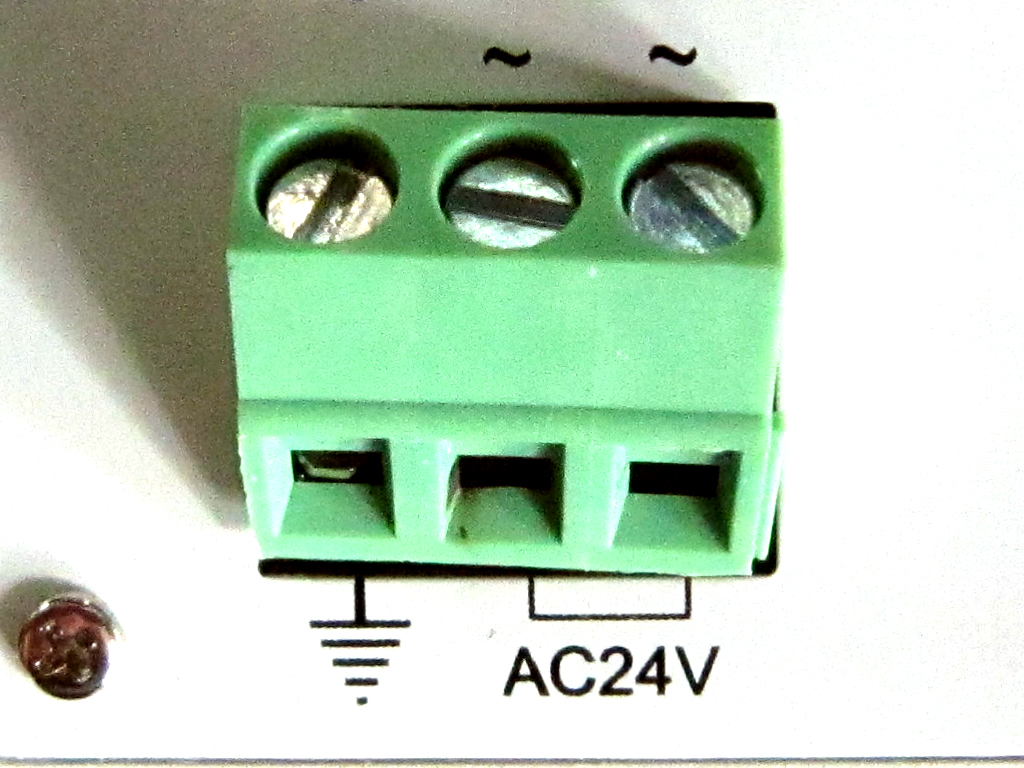

Mr. Anonymous 0 Posted March 8, 2014 Okay that is what I wanted to know so it is + - + on the AC adapter? I took this picture of my actual unit next to a camera I am going to try which is 24vAC (they did not send me the adapter that was in the eBay photo) I am unsure how to go about wiring it to the 3 terminals on the camera though, I know the left screw is for the ground which is the middle screw on the AC adapter. The two right screws seem to be the same thing is this for a redundant power supply or daisy chaining the cameras together? Share this post Link to post Share on other sites
fertilebert 0 Posted March 8, 2014 See my previous reply , it's AC (alternating current ) put the ground to the ground ,and the other two wires don't matter which way round you put them . Really if you don't know something as basic as this , then you shouldn't be messing! Share this post Link to post Share on other sites
Mr. Anonymous 0 Posted March 11, 2014 I am aware of the difference between AC and DC but I have never really worked with AC like this before. All is good it is up and running thanks, this cheap little camera gets pretty warm quickly. Share this post Link to post Share on other sites
