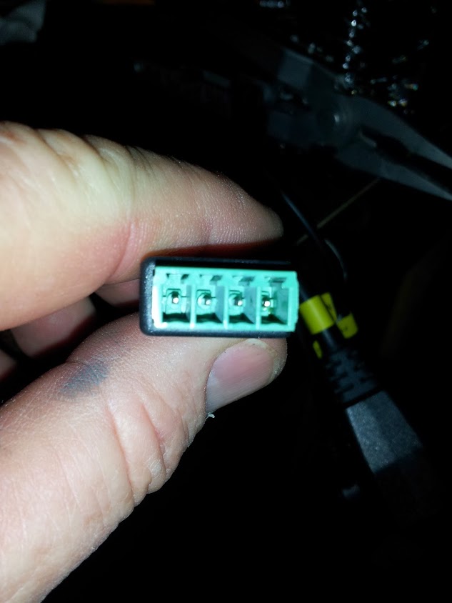

I am wondering if anyone can tell me what type of connector I need to connect to this I/O Terminal on a wireless security camera?

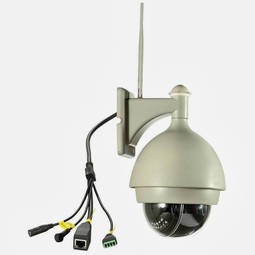

The picture I posted shows the terminals. They are neither screw down or push in. The camera is a generic one I order on ebay (see picture), but I have seen many Wireless IP cameras with the same type of I/O Terminal. I just can't find the type of connector that I need to connect to them. \

These are generally made by Phoenix Contact but make sure they are 3.81 mm pitch and 4 way.
They do some of these at Farnell and RS components but don't think they have a 4 way one but you
could get a 6 way and cut it down I suppose.

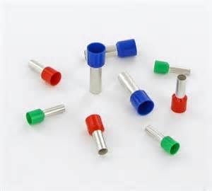

These are failly standard in the CCTV industry. Before you put your wires into the terminal block crimp wire end ferrules on the ends to stop the wires from fracturing and you will have years of trouble free use. Even coat them in 'Contralube' for even better connection. (not to be confused with silicone grease, which is an insulator and will have the REVERSE effect)
