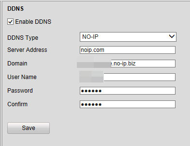

BassTeQ 0 Posted March 13, 2014 Hi all, Im trying to setup DDNS on a hikvision NVR, does the below image look correct, eg the Server Address and Domain? I know the user/pass are correct, I'm just not seeing the NVR update the IP with the no-ip website. I cant find any logs on the NVR to view so not sure how to check why its failing? Any ideas? Thanks Share this post Link to post Share on other sites
Securame 0 Posted March 13, 2014 The server address repends on the provider you are using. For dyndns.org it used to be members.dyndns.org. From what I see on no-ip (which I have never used), it is dynupdate.no-ip.com (from http://www.noip.com/support/knowledgebase/setting-up-dynamic-dns-updates-on-a-d-link-di-604-router/ ) Everything else looks about right. Share this post Link to post Share on other sites

cambridge 0 Posted June 20, 2014 I know this is a little late, but for what its worth, I managed to get it working by skipping the user name in the domain box. i.e., in this case, just use: no-ip.biz and set the server as dynupdate.no-ip.com as someone else suggested. Share this post Link to post Share on other sites
