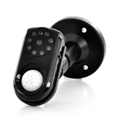

shirley842 0 Posted April 16, 2014 How about you install a security camera like this? It is black and small, you can install it in the dark place, it can detect any motion and take the picture and then send it directly to your phone whenever you are! Very simple to use. Share this post Link to post Share on other sites
