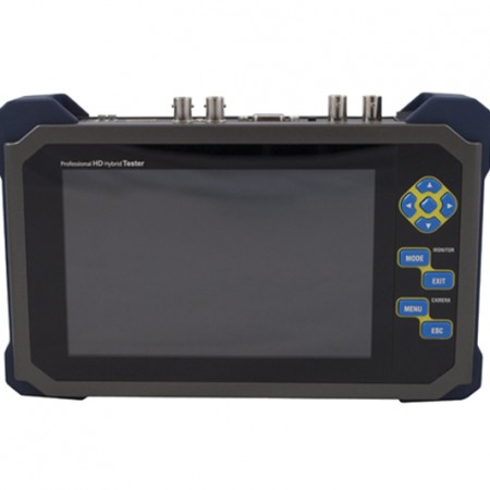

Thats a fair comment, I found out that when my original meter started to play up I was virtually up the river without a paddle however I had to buy a field test monitor anyway and I knew I was going to be doing the IP training so some sort of upgrade in that direction was on the cards. The only other device that appealed to me is way out of my price range, that 7 inch hybrid test field monitor supplied by Genie.
Genie CCTV's SDI07HY Circa £1000 - £1200 GULP!
