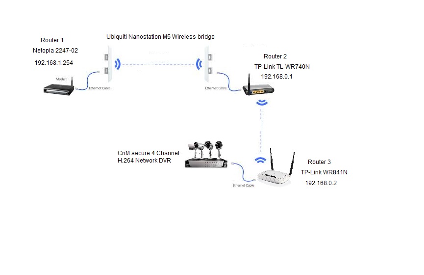

The thing is i have more than one router on my network which is probably making things more difficult
this is a picture of my setup
Hmm you have a quite complicated network for a house!
Ok firstly make sure router 2 and router 3 are not working as routers and they are only doing switching for you.
(You probably don't need their full firewall protection either)
If the above is done properly: You must do the port forwarding on router 1 not 3.
Otherwise you may have to do it on all 3 routers.
Try to undrestand the principal of what you are about to do, because otherwise you might go round in circles.
