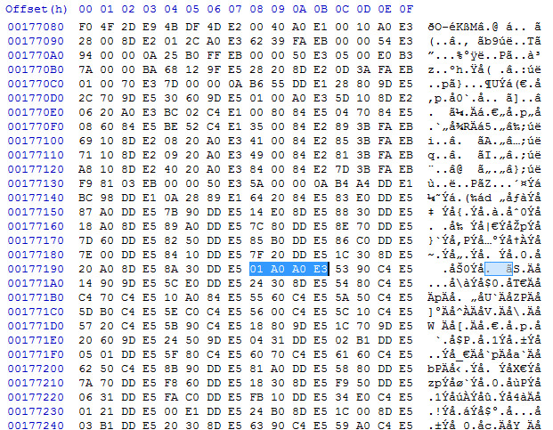

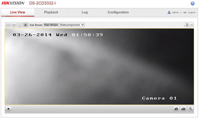

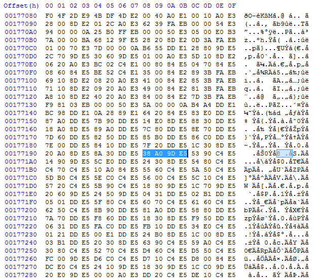

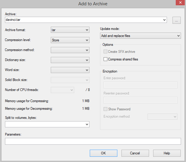

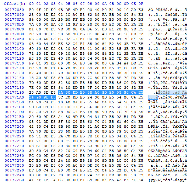

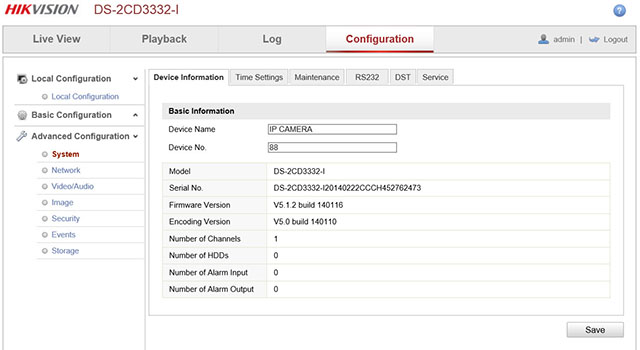

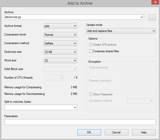

buellwinkle 0 Posted March 25, 2014 This is not for the faint of heart, so you have been warned. Thanks to CBX for figuring this out on 5.1. This is for people that have 5.1.2 already installed on the camera. The latest firmware, 5.1.2, even if you install the English firmware on China region cameras will be all in Chinese with no option to change to English. If you follow the instructions, you can use 5.1.2 all in English including the day of week and all the menus. HARD WAY 1.First, if you are doing this from Windows, pickup a few free tools (putty, 7-zip & HxD) 2.Login to the camera via the browser 3.Go to Advanced Configuration -> first category (System) -> last tab -> check Telnet 4.Use Putty (or your favorite telnet program) to login. Use the browser password (admin/12345) 5.FTP the Davinci file to your FTP server (you can get free software for this, but I used my NAS at 192.168.0.3) - /bin/ftpput -u username -p password 192.168.0.3 davinci.tar.gz /dav/davinci.tar.gz 6.Grab the davinci.tar.gz file from your FTP server 7.Use 7-Zip on Windows (or whatever tool you want to use to unzip, un-tar the file) and first unzip the file, then tar the file to extract the davinci file, almost 10MB. 8.Open the file with the hex editor (I use HxD) 9.Search for 8a 30 dd e5 38 a0 9d e5 53 90 c4 e5 14 90 9d e5 10.Change string from 38 a0 9d e5 to 01 a0 a0 e3 BEFORE AFTER 11.Save 12.Tar the file, gzip the tar file (I used 7-Zip) 13.Copy the file to your FTP server 14.Put the file back in the camera - /bin/ftpget -u username -p password 192.168.0.3 /dav/davinci.tar.gz davinci.tar.gz 15.reboot (just type reboot in telnet) 16.Login to the camera and all is in English - EASY WAY Some people like it easy, so here it is. 1. Follow steps 1-4 above to log into the camera 2. Download the davinci.tar.gz file from - http://www.networkcameracritic.com/Hikvision/davinci.tar.gz 3. Start from step 13 above. Share this post Link to post Share on other sites

buellwinkle 0 Posted March 25, 2014 I tried the easy way on a few different Hikvision cameras including 3332, 2032 and 2732 and no problems. It's actually a faster process than loading 5.1 on top of 5.1.2. BTW, I played with the NAS CIFS/SMB stuff with 5.1.2 and it does the same thing as with 5.1. It lets me format it and as soon as you try and write an event video to it, it goes uninitialized. The only thing that I can see that's fixed over 5.1 is the ability to get a snapshot using an URL command like what worked in versions prior to 5.1. Low light performance seems the same to me. Share this post Link to post Share on other sites

CBX 0 Posted March 26, 2014 Thanks to buellwinkle for that write up - I did the patch for me, but glad my patch is actually useful to some others too I didn't post the binary as you are posting copyrighted code, but hopefully Hikvision won't mind I don't know why they don't include an option to have day of the week in English on all cams so what do I know! The problem with changing the flash, aside from the technicial difficulties, is that it would be detected in future firmware updates if Hikvision were so minded to check. They could do anything they wanted to your camera (up to and including disabling it). Without knowing their motivation for having the day of the week limitation, and the recent added issue of all menus in Chinese (which seems an escalation of their part), I'd be reluctant to make permanent changes. Has anyone asked them why they do this? For reference the original patch info and other tech notes is here: http://www.cctvforum.com/viewtopic.php?f=19&t=39874 Share this post Link to post Share on other sites

dvb 0 Posted March 28, 2014 Hi, Thanks for the tips ! I think that "NFS workaround" isn't fixed in this firmware. Do you think the workaround (*) for 5.1 is working on this 5.1.2 ? Cheers ! (*) 5.1 Version search for the following hex string: 5001DCC09DE54900001A0B005CE14700001A and change it to 5001DCC09DE5000000000B005CE100000000 Share this post Link to post Share on other sites

Roswell426 0 Posted April 24, 2014 Thank you Buellwinkle, it in nice to see the menu screens in English, and not have to wait for google translator to try to fix the chinese menu screens. After I got the menues in English, I modified the davinci file for the NFS workaround mentioned above by dvb. That fix allowed me to get to 'Normal' state with my Asustor AS-604T NAS and both Hikvision DS-2CD2432F-IW cameras. It is recording mp4 files now on the NAS! Share this post Link to post Share on other sites

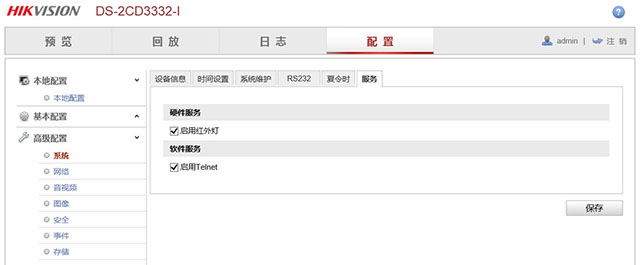

UncleRedz 0 Posted April 29, 2014 If this is the fix for those that are not faint of heart, then here is a workaround for those that are. Using Chrome or similar browser with web developer console, 1. Go to the camera logon page. 2. Open the developer console. (In Chrome, hit F12 or Ctrl+Shift+J) 3. Type: chooseLanguage("en") and then hit enter. The language should automatically change to English. 4. Continue with the logon. This is not as permanent as the solution discussed in this thread, but it works well without changing anything in the camera. The JavaScript function, chooseLanguage, is what would have been called, if you had the choice of selecting English in the combo box on the logon page. Share this post Link to post Share on other sites

buellwinkle 0 Posted May 8, 2014 Two reason, one is they come out with say 5.1.3, you would have to get the Davinci tar file and see if you can apply the same fix by searching for the string. The other reason is understanding how to modify the code as CBX has published changes for other issues like the NAS issues but is a Linux guy but you can use the process above to apply his fixes but in the a Windows framework. Share this post Link to post Share on other sites

CBX 0 Posted May 9, 2014 The other reason is understanding how to modify the code as CBX has published changes for other issues like the NAS issues but is a Linux guy but you can use the process above to apply his fixes but in the a Windows framework. Well the Chinese > English patch is mine, and some other stuff I've posted in a different thread - but the NAS fix is who done by someone else so the credit for that goes to them (not sure who that was as I don't use it). I don't actually change the bytes in the davinci file or it's tar container, but rather patch the program in memory just before it runs. But that means changing a script on the (linux) camera which isn't for everyone and runs the risk of having to reflash your camera if you mess it up. And as for the hard way issue - posting the patched binary may be a copyright violation of Hikvision's code - whereas posting the bytes to change isn't. Though in practice they could object to one, neither or both if they wanted to to some degree. Share this post Link to post Share on other sites
buellwinkle 0 Posted May 9, 2014 I tried it as your described,But still display chinese version.i don't understand it,Pls help, It can still display in Chinese, but gives you a language drop down in the upper right where you can select English before you log into the camera. I've done this on dozens of cameras and maybe 1 or 2 I had to set it to English from the drop down. Share this post Link to post Share on other sites
