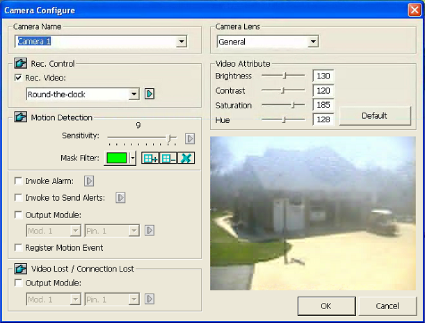

rheide 0 Posted April 19, 2014 gb5102 - thanks for all your input. Can you tell me if this is the "Camera Configure" screen you are talking about? I don't see any codec options. Also, if anyone else can comment - is there some place to tweak the bit-rate? If I can just set it to a CBR, this should take care of everything. Thanks again! R Share this post Link to post Share on other sites
gb5102 0 Posted April 19, 2014 Yes, that's the right screen, click the green arrow next to "Round-the-clock" No way to set CBR... Share this post Link to post Share on other sites
gb5102 0 Posted April 19, 2014 Also, just a heads up, there is a setting for h264 codec called 'noise detection to reduce file size' which basically 'blurs' areas of the image where it sees a lot of noise. It does save space, but i find the effect to be really annoying, also it causes loss of video information so you could easily miss something important, IMO. Share this post Link to post Share on other sites
