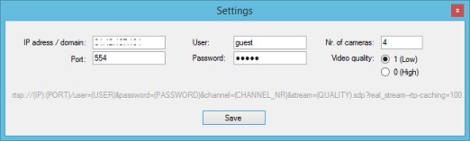

It's written in .NET using VLC Media Player ActiveX library. It plays RTSP stream from URI like:
rtsp://(IP):(PORT)/user=(USER)&password=(PASSWORD)&channel=(CHANNEL_NR)&stream=(QUALITY).sdp?real_stream--rtp-caching=100

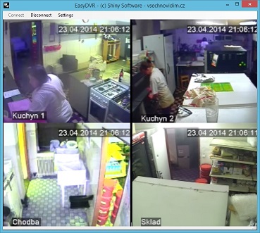

It took about 15 minutes to create it, so it's not bulletproof and maybe it can be sometimes unstable, but maybe can help somebody who is looking for the easiest Windows based DVR viewer for noobs (i.e. my customers - they can only click on "connect" and just look at stream).

Screenshots:
