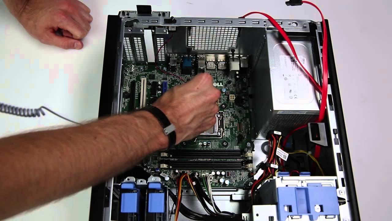

I went the opposite way on commercial installs with a Dell T20 with the Xeon processor. On sale it's cheaper, but full price is $499. It's probably close to a consumer grade i5 processor in performance which is way more than enough for say a dozen cameras on XProtect (at home I run 10 cameras, mostly 3MP, all full frame rate on an old, old i3-540 processor). It has 6 drive bays, 4 are 3 1/2", easy to pop in. It's made to be a 24/7 server so the fans are beefier, the components are beefier, overall well made compared to their consumer PCs and it's small, about the size of a regular desktop.
Do you need drive cages to add more drives to the T20 or do they come with?
It has these green plastic drive holders. You ply them apart and pins in the holder go into where screws would go in on the side of the drives to hold it in place. Then it clips into the chassis, 2 at the bottom, 2 on top. The cables are already there, just plug them in, but not like a drive cage, you have to plug the sata and power cable in.
