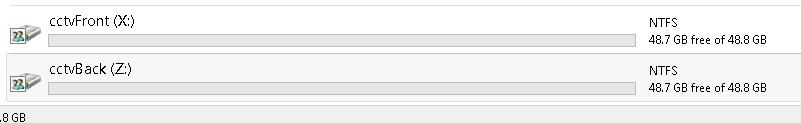

On the Windows side I have allocated two new empty partitions, 50GB, each to the cameras and have created a share for each of them. On the permissions side the username that I am logging in with has been configured with full read, edit and modify rights.

Here are some screenshots of my config, I am not sure there is anything particularly strange there. I should also note that I did a factory reset on both after loading the new firmware. The only changes thereafter were:
- Password change for admin & new user created
- All ports changed (Http, RTSP, HTTPS, Server) for forwarding purposes.
Here is my config:
Windows 8 Setup

It turns out that for some reason (must be a windows problem) the test fails if the network share does not have its own drive partition. I managed to get it working by creating two new drive partitions one for each camera and then connecting to a network share dedicated to that partition.
