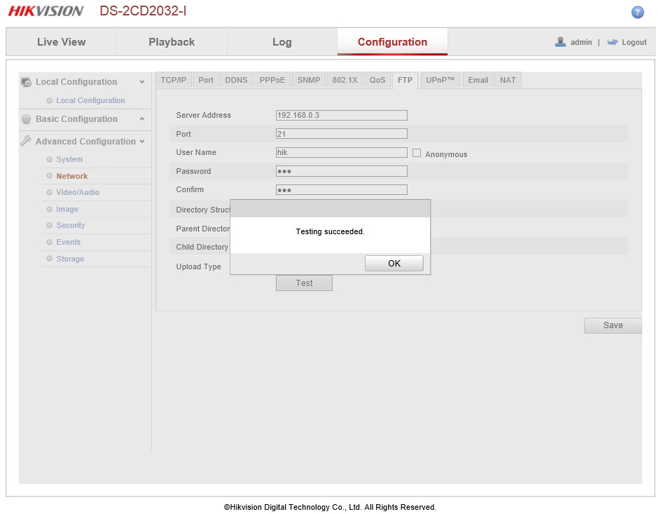

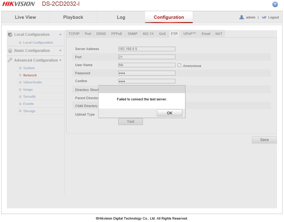

I had no trouble installing 5.1.6 on top of 5.1.0, China version camera, applying the hack and all working fine, all in English. The test buttons are there but did not test each individual button but some. For example, I tried the FTP one, test as shown below. Really, unless you are having a problem with your camera you should not upgrade the firmware. It many times breaks more than it fixes.

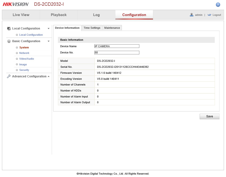

Here's the firmware release info
TEST Failed
TEST Succeeded
