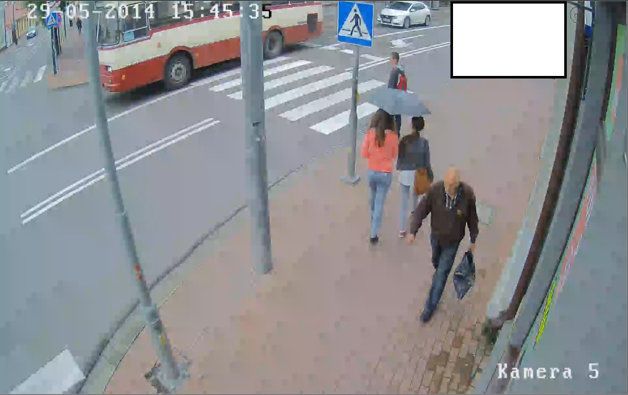

osama84 0 Posted June 3, 2014 I started about a month ago monitoring cameras (5 pcs) HIKVISION DS-2CD2132-I 2.8mm + recorder DS-7608NI-S / P All cameras work well pza one who a few days ago suddenly she started to record just like the pictures. What could be causing this? Change the settings to lower parameters (1.3megapixel slightly improves image) How do I set 3megapixel it has just such a picture shows up (even when 2.0Megapixel) problem : link to youtube https://www.youtube.com/watch?v=2YzTYG24Pzw&feature=youtu.be I'm sorry for the mistakes but poorly know English Share this post Link to post Share on other sites
MaxIcon 0 Posted June 4, 2014 Assuming your resolution is really what it claims (720p or 1080p), this looks like the bit rate is too low. Your image is being compressed too much by the firmware. Check your bit rate settings, and make sure you're on stream 1. 4096 kbps should have no problem, and even 2048 kbps should look better than this. Share this post Link to post Share on other sites
