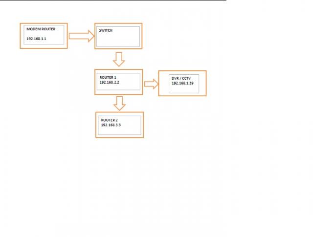

Dear Masters,
Kindly help me with my problem, I have searched the forum but cant find a solution, maybe im missing a simple thing. thanks
setup
(see image link below)
switch is directy connected to modem / router
router 1 lan port is directly connected to switch
router 2 lan port is directly connected to router 1 lan port
dvr / cctv is directly connected to router 1 lan port
router 1 and router 2 has both disabled dchp in settings and getting ip address from modem / router
What I can do.
I can access the internet from all routers and modems
I can view the dvr locally when connected to router 1 and router 2 but not when im connected to modem / router
i can remotely view my dvr when im connected to 3g but not when im connected to router 1, router 2, modem router
What i WANT to do
I want to access the dvr locally (192.168.1.39) when im directly connected to modem / router (192.168.1.1)
*****************NOTE, IMAGE IS WRONG.*********************
ROUTER 1 is 192.168.1.2 ROUTER 2 is 192.168.1.3
both have disabled DHCP
Does your modem have multiple ports? I am thinking that when you are directly connected to the modem, it is assigning you an IP address outside of your home network.
First of all, connecting directly to the modem seems a bit odd to me. May I ask why you are doing that when you clearly have more than enough ways to connect?
Hello, thanks for the response..
im connecting to the modem/router whenever im in my office because its in the first floor and the router1,router2 and dvr is in the 3rd floor of the building.
i want to connect to the dvr whenever im in my office connected to the modem / router.
the router 1 and router 2 is set to disabled dhcp so the modem / router is the one giving ip address to the dvr.. any thoughts? thanks
what brand is this thing (modem)?
what IP is the DVR?
what IP do you have on your machine when on the modem?
what IP do you have on your machine when on the other two routers?
